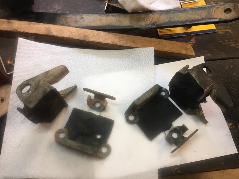

What I didn't do when it was failing was to LOOK at the shifters when the issue occurred. So today I crawled under and looked. Both motor mounts are smoked, totally separated into two pieces. So that explains how it could go out of gear while under heavy load, and I didn't look at the shifters when it was failing, only afterwards when I had clutch in and nothing was in a bind. So I jumped the gun in a panic because I'm leaving out soon to Windrock for the Jeepster Jam. I'll post a pic of Chinese motor mounts shortly...
