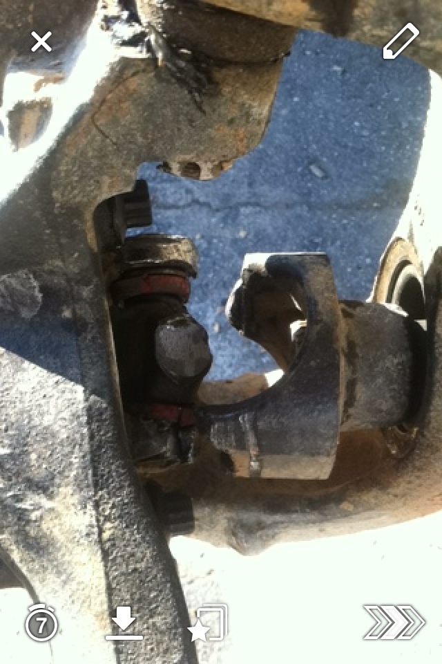

Don't dd it, the ears have broke on every set of shafts I have put in. The last set I put a set of almost alloy tabs that cover the whole ear and are suppose to reinforce them and they still broke. (Although looking at the tabs it looks like I didn't have enough heat. The u-joint it's self was still intact just laying on the ground cause the tabs and ears blew up
this is not from Saturday but pretty much the same failure, these shafts had new u-joints installed after I got my axle back from
You Jody, 3-4 trail rides and maybe 50 street miles they were splicer joints
