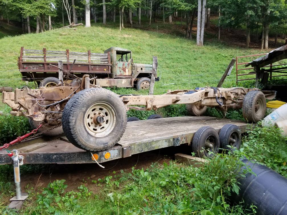

So I read that link and actually called arb. They said that is possible but the 50 locker is just under a $1000 and you have to buy the whole gear set which is about $500.soooo I'm probably gonna just try and sell it as a whole.so if you know any body I have a 2001 ford f250 superduty frame,gastank and axles $600
