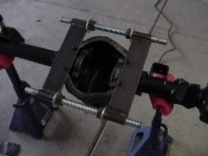

why not just make one? all you need is two sections of threaded stud, two small pieces of plate, 4 pieces of pipe or tube, some washers and nuts. i made one for less than $10
