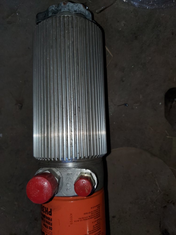

Ok thanks, how does the cooler tie in? The one I have has 2 different size fittings
