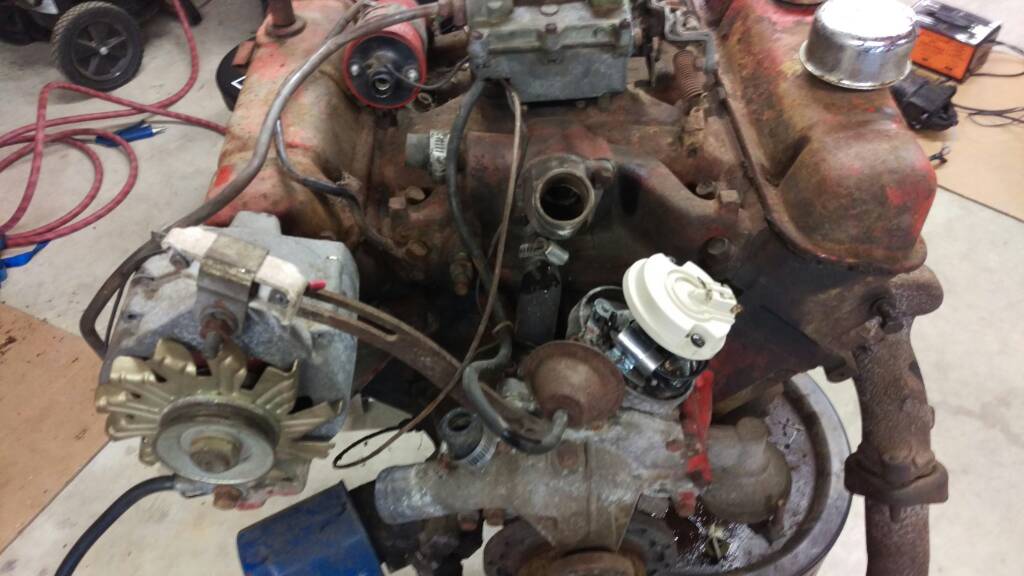

This is going to be slow going, but I'm starting to tear down a Buick 225 I picked up from a board member. It's getting thrown in my 1970 CJ-5 for a little more get up and go! I just have to figure out how much money I want the rebuild to cost. Hope to have it in by summer.

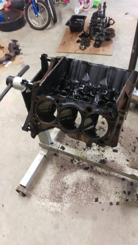

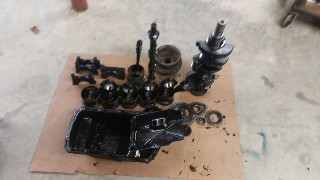

I'm a little tripped out at what I found tonight. It's torn down minus the crank and cam. The pan was full of big metal. Like .125 thick stuff! I don't know where the hell it came from. Nothing is broken. It did have aftermarket head gaskets. Maybe something in the top end came apart and they did a quickie fix and didn't pull the pan.
Check the skirts on the sleeves of the clyinder bores. I had the issue with mine when I first bought it and it half ass blew up on me when I was messing around before we pulled it out of the donor car (HUGE smokey burn out and too many rpm's) lol
How do the lobes on the cam look? A lot of material could come off of a rounded off cam.
Edit: and a distributer drive gear.
I didn't notice any of the skirts with issues, but I was trying to get it torn down quickly to help get the kids to bed. I will smoke it over a little closer tonight.
The lobes on the cam look nice and the drive gear is fine. The drive gear and skirts were my first thought. I will have more time this weekend to check everything over better.

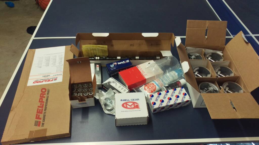

Getting started again. The big brown sleigh stopped by today. I decided on the 225. It's at the machine shop waiting on my pistons that showed up today.
