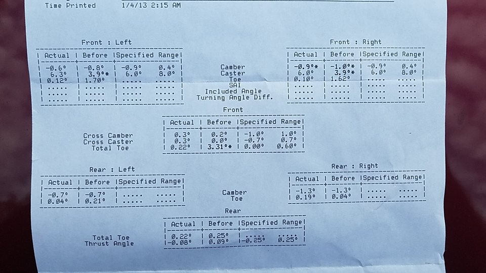

Situation:
I have an LJ: 3’ coils, Cavfab steering setup,drop pitman, rubicon express short arms front&back on 35 stt’s. NO ISSUES at all.
So, I upgraded the 3’ coils to 4.5 metalcloaks.. installed teraflex adjustable track bar front and back. Experienced Deathwobble .
So, I changed 4.5 coils to 3.5 coils to lower it back down. Experienced Deathwobble.
So, I changed short arms to Claytons Long arms front&back, Experienced Deathwobble.
So, I said fuck it, changed wheel bearings, changed steering to Currie Correct link steering, changed knuckles to stock, changed pitarm to stock, new bilstein shocks. installed a New adjustable front track bar. Experienced Deathwobble.
Steering is tight, ball joints are Tight.
More caster?????
I’m about a match an a gallon of gas away…
Don’t torch it. I’ll take it off your hands. Check track bar and you should have between 5*-7* caster measuring off the top of the C with the vehicle sitting level on all 4’s.

Which track bars, and how are they mounted? Like Jody said, you need a helper to shake the steering wheel back and forth while somebody else checks each joint for movement. Something is moving. Most likely culprits are track bar, tie rod ends, ball joints, and wheel bearings. Track bar and tie rod holes can be ovalled out, bolts might not be tight enough, axle nuts might be loose, stupid little track bar drop brackets are a recipe for disaster, etc.

To answer a few points made: Everything is new,except Ball joints&steering box... Ball joints are tight, zero play. At this point, not much left besides a caster issue??? which by the math i'm well within spec.
Jody...someone asked earlier, the first track bar was a moog, 2nd track bar was an adjustable teraflex... Brand new one on it is another adjustable teraflex.
nickmaul...Roters? Never heard of rotors causing DW.. but they are new anyways.
junkxj..No, track bar does not have a drop down bracket, stock location on axle mount.
shawn/jody.. track bars are mounted in stock location, stock pitman, stock axle location.
