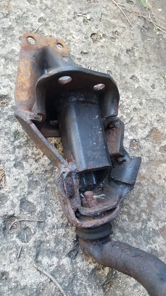

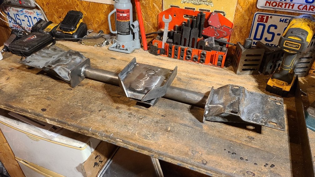

Kustom drop trakk bars brakit
Pefekt 4 Rat Rod $375
CL find of the day:

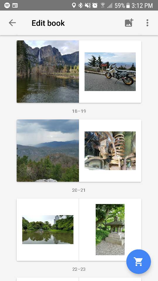

Looks like art to me! Put in in the Googenheim!Yesterday, Google Photos suggested a "Highlights of 2017” album that had been auto created. Rat rod t-bar drop brakkit made it in

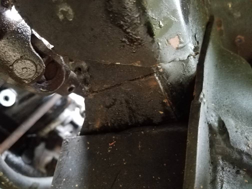

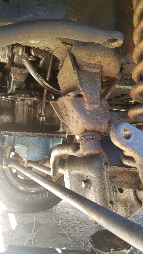

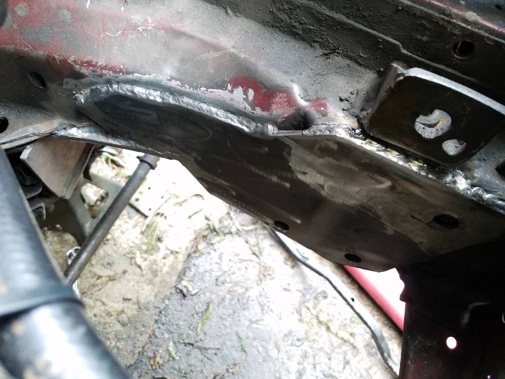

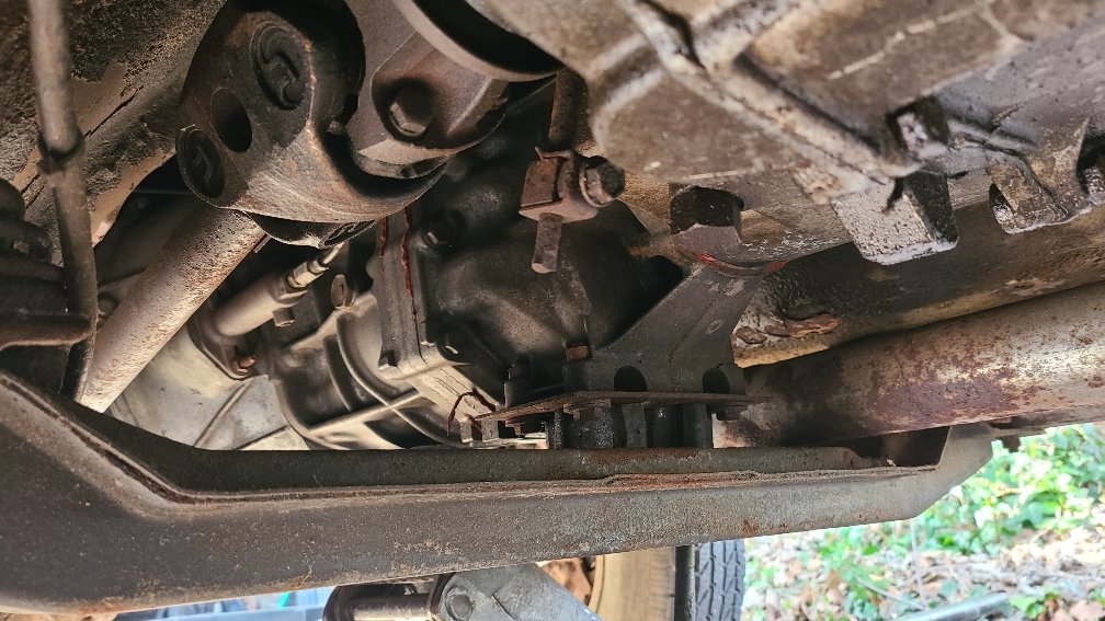

Better picture of the crack:

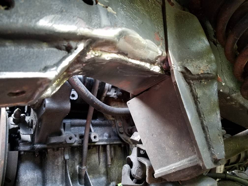

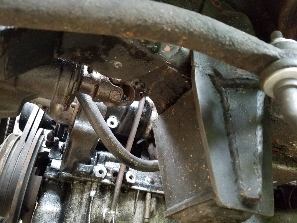

It started where the original builder booger notched the unibody and went all the way around to the outside. The pinch seam was almost completely removed so the inside and outside sections completely broke apart. I decided to plate the inside of the frame to get a solid connection from the steering box mount to the trackbar mount.
Then drilled and welded the crack and covered it with reinforcement.
Don't pay attention to the poop weld.

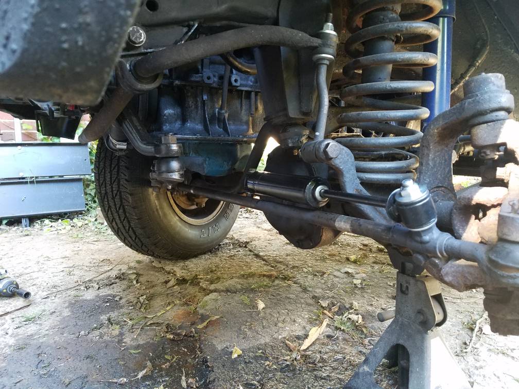

Also added a steering stabilizer. We'll see if there's any improvement.

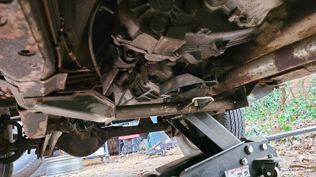

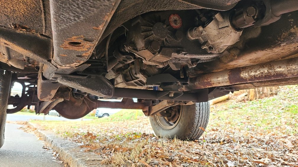

It's an illusion in that picture. There isn't an angle to get a good shot, but the oil pan is completely in front of the axle tube. The tie rod is the limiter of the uptravel.That pic makes it look like the oil pan is really close to the front axle at ride height.
Sorry, never saw your post.How high is your rig's ground clearance?
