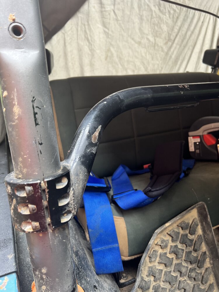

Did I put my harness bar in upside down?
BigClay
Knower of useless ZJ things
Sep 24, 2008
Winston-Salem
What say ye? Is this upside down? Should the harness strap tabs be on top and not on the bottom?
That's the way I put mine in. If I put it in the other way, it would have been too low IMHO. The bar is at the correct height for the seats with the retainers under the bar.
They are there to keep the harness from moving. I don't think it matters up or down.
As long as the attachment of the shoulder belt is in line with the top of the shoulder (and if not slightly high but never never never below the shoulder /collar bone) it’ll be fine
This. You don't want the straps to end up pulling downward. However you acheive that... doesn't necessarily matter.
I can't imagine that back seat is much fun to get into with this in place, especially with harnesses attached.
