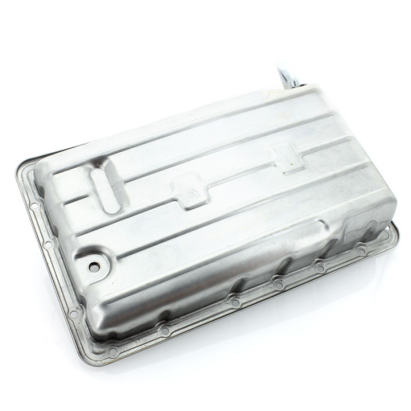

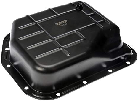

I’ve never seen one in a 99 usually aw4 but easy to tell diff tho 42re has a corner cut off on side and oil drain plug is on side I believe aw4 is all square but a tiny corner missing and plug is in bottom of pan! I got pics but google prolly has side by side of all of em!

42re
AW4
Just have him snap a pic real quick. They are totally different looking pans. Too easy to figure it out.
