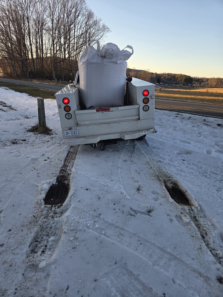

Right to work. 2k lbs of feed.

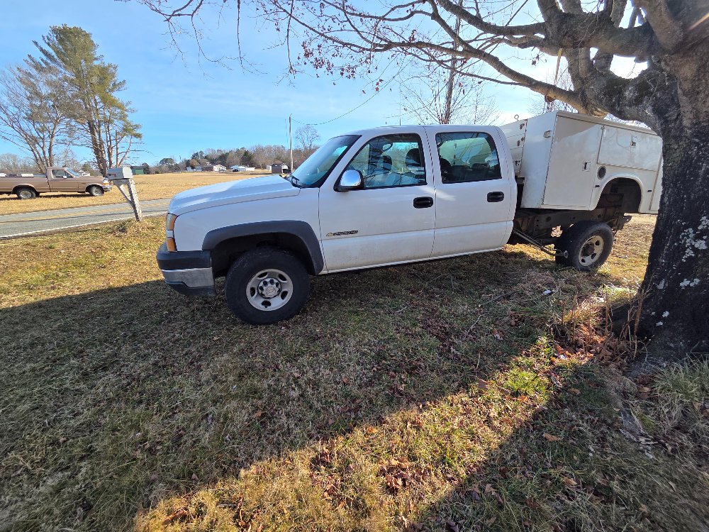

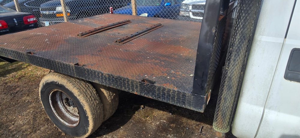

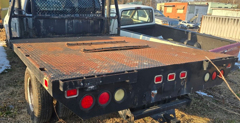

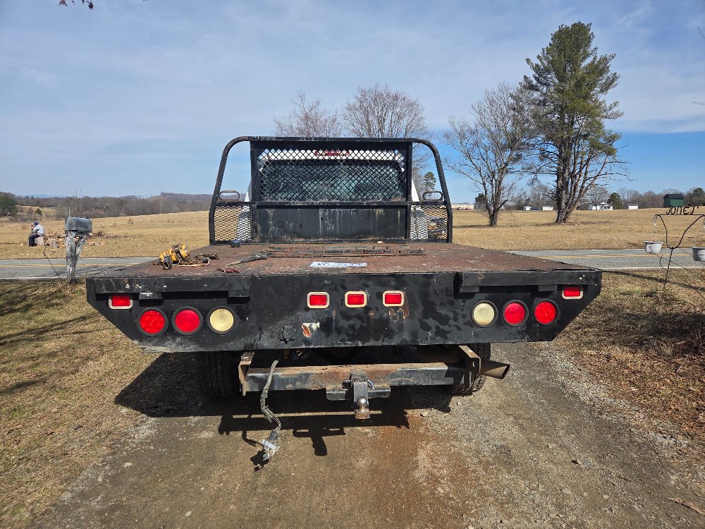

Got this one pending on a straight trade. Its off a DRW but the frame width is the same.
I *think* the only one of the GMT800s with a different frame width were the C&C trucks. Honestly, I'm not even sure IF they were a different width.
That's a solid trade though! People are real proud of flatbeds and the prices seems to reflect that. Free fifty free is always a good price in my mind. Free ninety nine, if you will. :D
Thats what im seeing. Based on some looking, most pickups up to 350/0 have 34" frame rail spacing. The c&c ones are a little different. Otherwise its just body width and cab to axle dimensions.
Yea im seeing most solid steel flatbeds in the 800-1k range. Aluminum is stupid high. But most of the service beds im seeing are in the 600-800 range as well.
Its actually the opposite. All cab and chassis trucks 350-550/3500-5500 have the same 34" framerail width with a flat top C-channel that is parallel from cab to tail and the same 60" or 84" cab to axle measurement regardless of manufacturer. Allows beds to be easily upfitted or swapped for whatever brand the fleets choose. Pickup frames are all over the place, from something like 38" to 51" or something crazy, and often tapering from cab to tail. With that said, if its a flatbed, you may just have to add 2 pieces of channel or something simple to make it work.
Yea, its steel so I'll just fab up whatever mounts are needed.

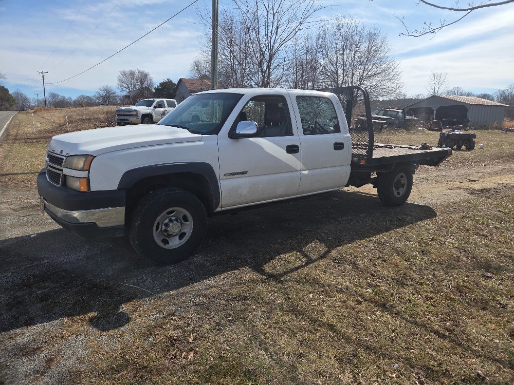

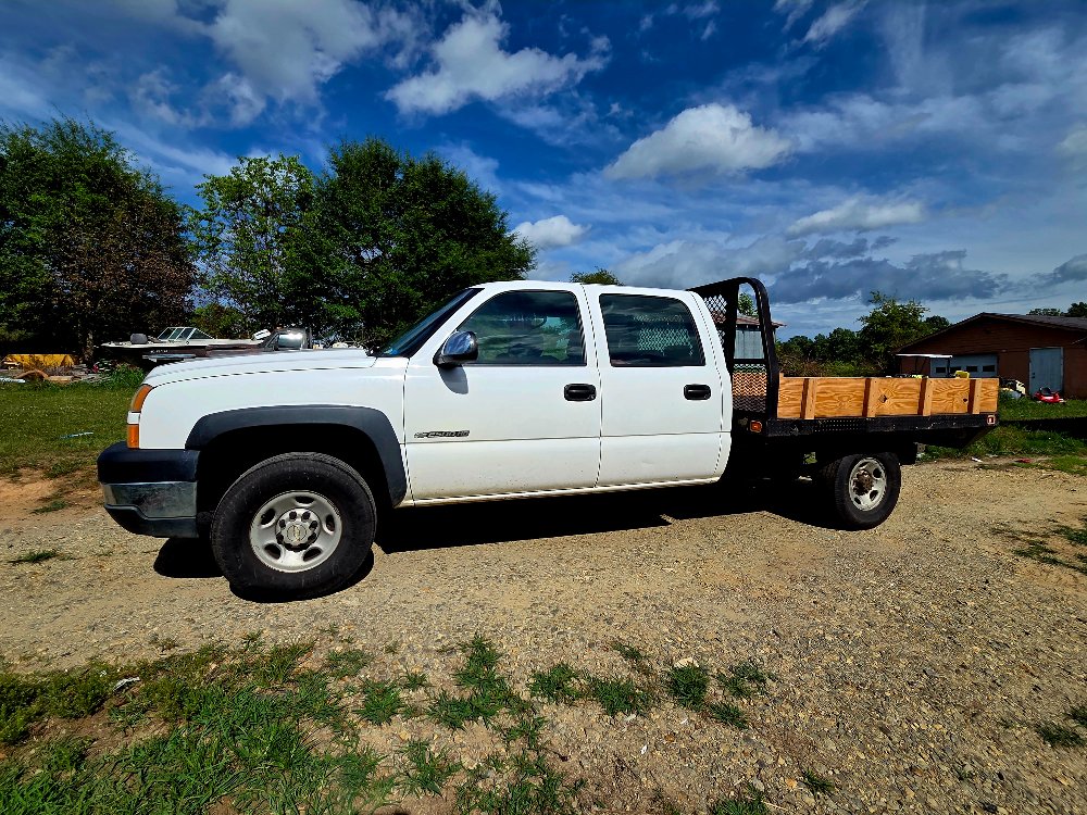

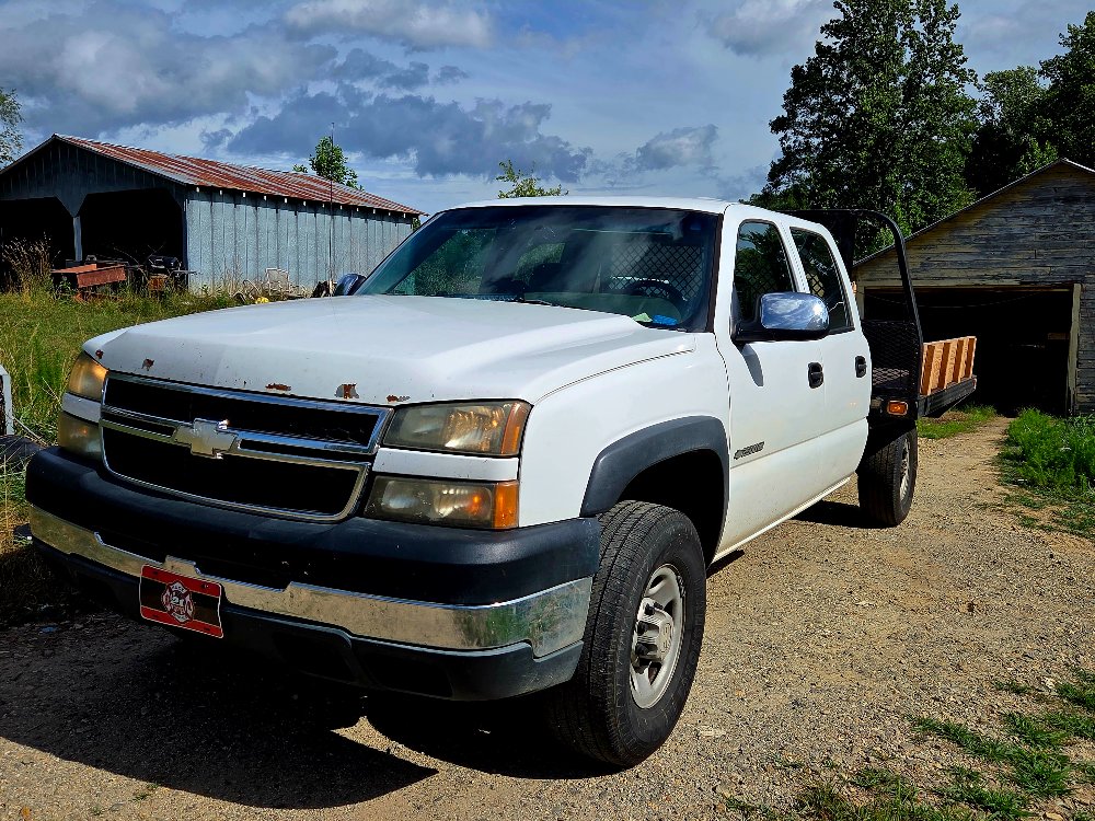

Finally got a little better picture.
Like a glove. Bonus, it has a goose neck ball and 5th wheel rails. Just need to trim the supports where the step/bumper was, or add a step, and wire up thw lights. New lights is gonna be the only cost.
