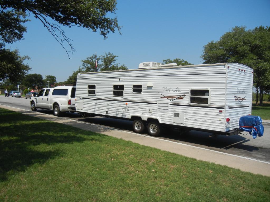

What you think is hi-mileage will affect what your options are in a diesel.My F350 had 164K on it when we left to go out west and never gave a mins trouble pulling a 32 foot camper.We were gone a month and drove a little over 6200 miles.
Cheap(er) diesels can be found but you really have to look and be a little lucky.I got mine for $5800 w 142 K on it.You might start out just towing once a month but if things work out and you have something that can tow you will be open to towing more.I honestly dont see how I got by as long as I did w/o a good truck and trailer.
