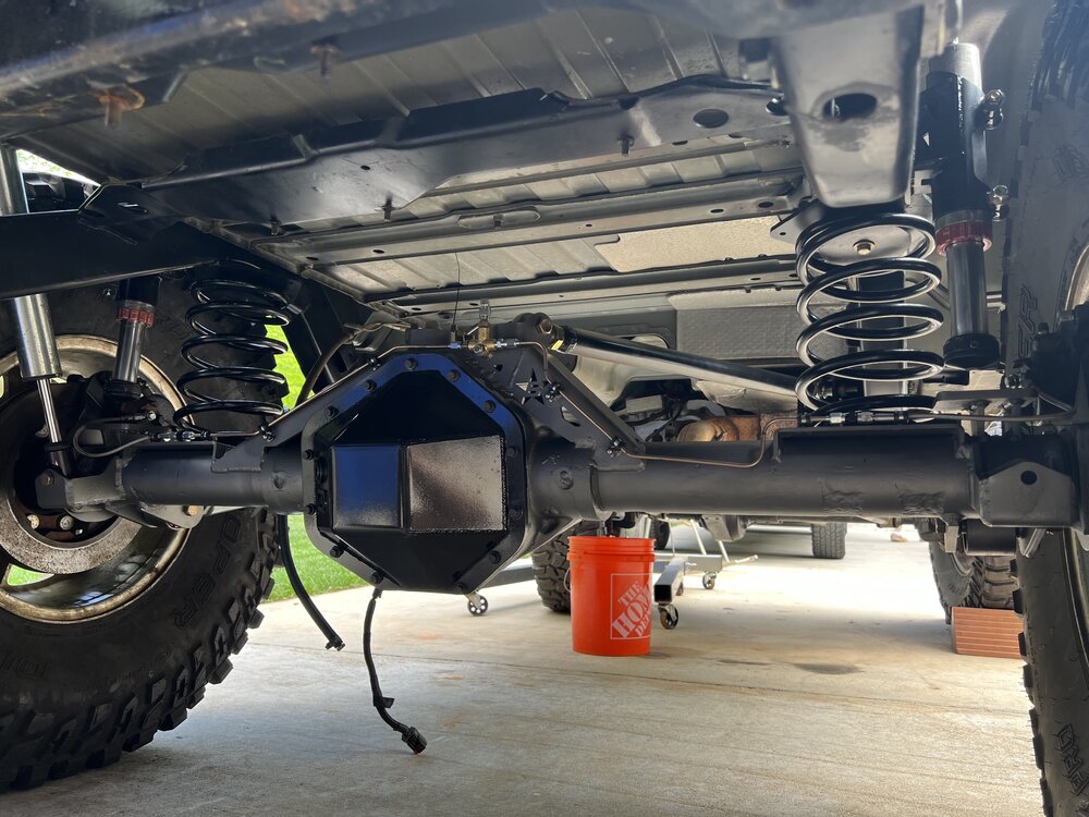

I generally prefer the fabricated steel ones. Barnes, RuffStuff, and Motobilt all have good ones. I got one of the Nodular ones from Barnes for my SD60 for the LJ because it’s super low profile and that’s needed for the SD axles. It’s not needed for the older 60s.
I actually have a 60 cover in the shop I picked up out of one of the Facebook parts groups before I bought the Barnes cover. I believe it’s a RuffStuff. We’re heading home from the beach today but I can get you some pictures in the next couple of days if you’re interested in it.
Several years back when I bought mine for my D60HP and 14 bolt, I narrowed my search down to Barnes and Motobilt. The Barnes covers were more expensive because they were machined flat after welding. I ended up buying the Motobilt ones. They are not flat. They definitely warped during welding. I expected better from Motobilt. I hope that they will pull flat when torqued down, but haven't gotten to that yet.

I’ve got no complaints with the 13 bolt Motobilt cover in the back of mine. I shaved a bit more off the bottom of it to match my cut/shaved housing and no leaks so far.

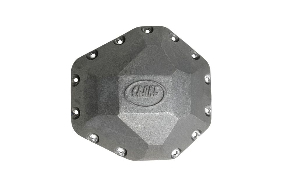

I’m leaning towards the Crane 13 bolt cover due to the material and no lip design. Not the cheapest option, but at this point in the spread sheet it looks like it. Checks all the
boxes.
