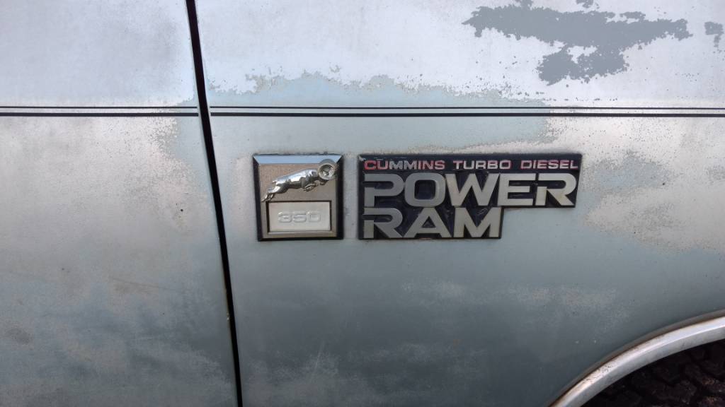

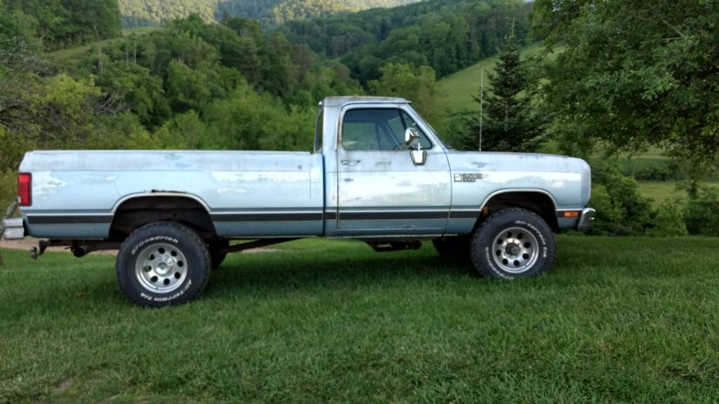

My dad has a 89 w350 that is single wheel from the factory

Well that's not a 3500 now is it :flipoff2: Seriously though, the single wheel 350s with the CTD were uncommon. It's cool that your dad has one.
