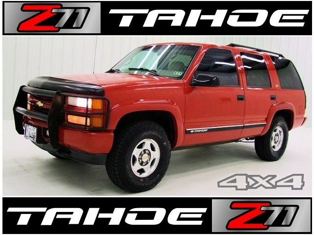

Z-71 used to be optional package (on 4x4 only)- skid plates, Bilstein shocks, G-80 rear diff, and the all important stickers! That was on the 90's trucks. I'd imagine on more current stuff it's likely pretty similar. On the round body Tahoes and Suburbans (2001+) it was a trim level with the same stuff as just listed but also some special body cladding, serial roof rack and special wheels. (also on the late 90's to 2000 (before the round body style) Z-71 package was on Tahoes and had body matched paint on grille, bumpers, and fender flares, and had a brush guard with a diesel model front bumper with auxiliary lights in the holes and special wheels) Like this (bug guard is aftermarket):
