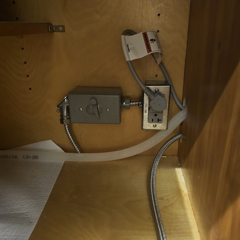

Well it's all done and functional. Dishwasher is ridiculous, I can't even hear it running.

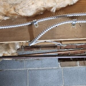

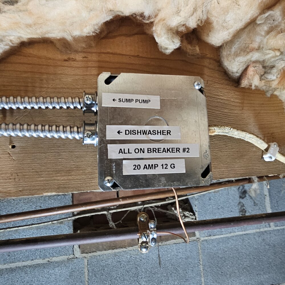

Went overboard on the electrical at the end of the day. Way more than what was probably necessary but I'm happy with it.
