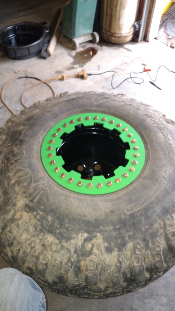

Just built some for my buddy
I think it needs more bolts. I don't think there are enough. ;)
