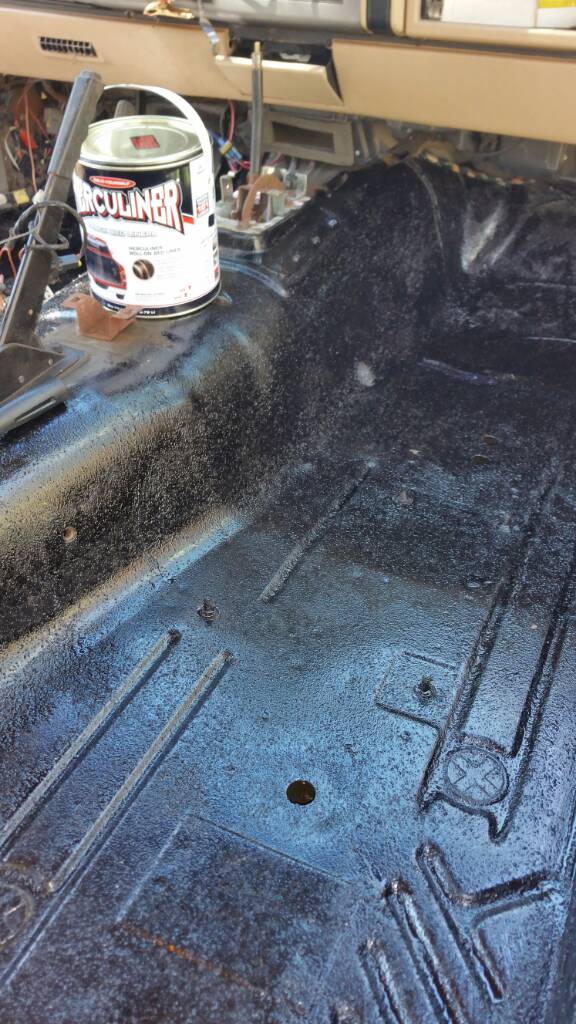

Lowes hardware has herculiner for 69$ for the kit

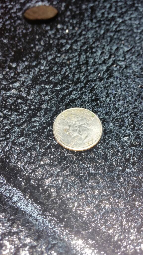

my jeep is painted with raptor liner. It has held up well the last 2 years. You can get it in black or tintable. You can mix what ever color you would like with it. It does not take much paint to tint it. Can buy in either a kit with the Spray gun and 4 quarts of liner for around $120 (be careful make sure it comes with gun, I have seen kits sold without the gun for same price) or can buy the gun by itself and buy it one quart at a time. The overall finish is smoother than hurculiner. I painted inside of my old scout with hurculiner and I had a hard time cleaning it cause it is a rougher finish guess due to rolling it on instead of spraying it on.
