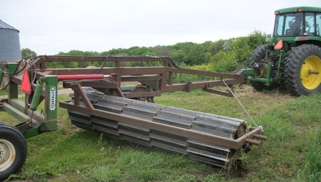

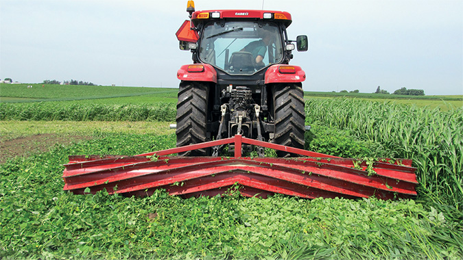

Looking for ideas/suggestions to make a DIY roller crimper for my food plots that I'll be putting in this month. For those that don't know here is a roller/crimper:

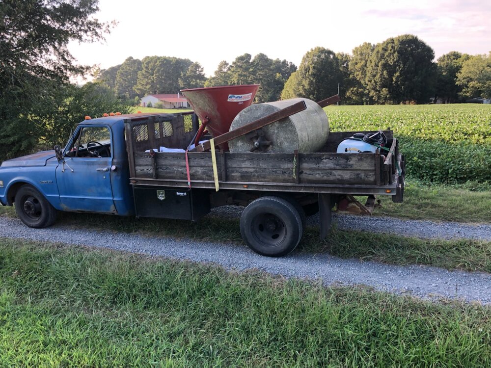

I have a roller that I made from a heating oil drum with some MH axle hubs welded to the ends and a scrap metal frame (in flatbed), but I want to upgrade it. Right now I'm planning to do something similar to the next picture with staggered angle iron or flat bar and either use sand or add a trailer axle as ballast. I've used water before, but the first rocks I hit made pinholes so it all leaked out.
Is there anything readily available for the spiral blades that I don't know of?

I would recommend a very fine sand for filler, because the weight would be more than enough and it won’t leak out if there are small, pin holes.
Angle iron, welded in the pattern of the one picture you posted should work just fine however, I would devise a way to lift it. Otherwise it will make a mess if you need to transport it from location to location.
