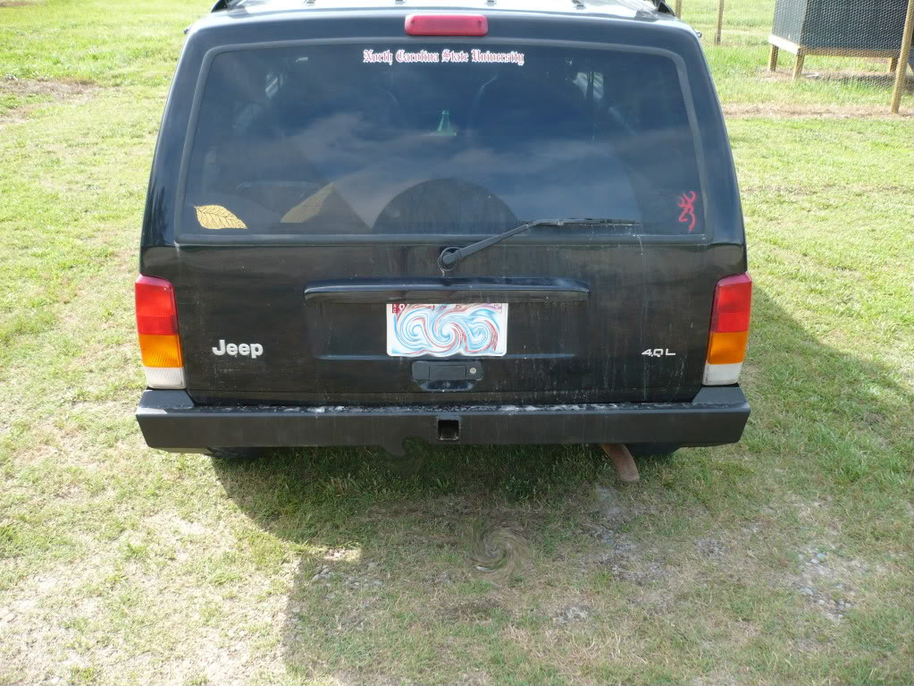

i prayed my homemade rear bumper with the rustoleum bed liner in a can and have 0 complaints about it. so far there is no discoloration when its clean. the only problem i could think of is the fact that it holds dirt really well, but i havent washed my jeep with anything other than a pressure washer in 3yrs so thats a non issue with me

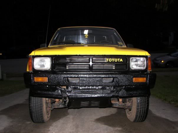

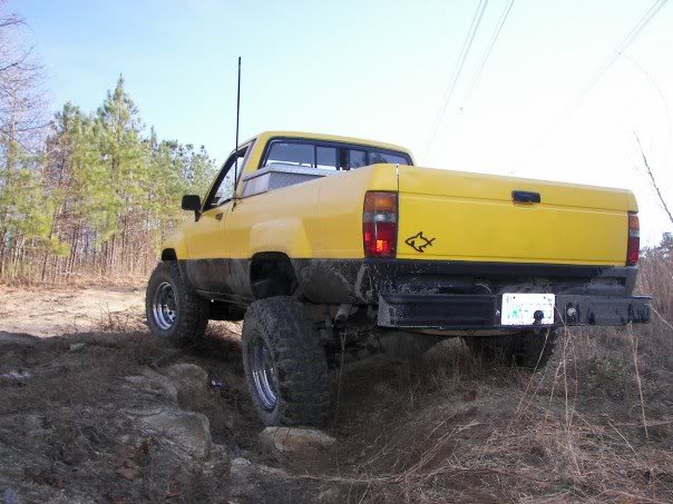

I used herculiner on my yota all the way around... bumpers and all. Worked great and held up really well against a pressure washer.
I used a coat of gloss black paint on top.
