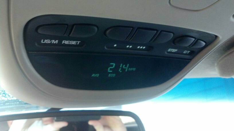

Ummmm, haha, if that's a V-10, you need to cough up the secret. I'm assuming its a 7.3 though.
Shawn has a 6 speed early 3rd Gen Cummins H.O. 2003- mid 2004 is the Holy Grail for power vs. performance vs. fuel mileage.
Must be something wrong with it however. According to the interwebz, it should get 25+ while towing 20k pounds uphill to Harlan.
Shawn has a 6 speed early 3rd Gen Cummins H.O. 2003- mid 2004 is the Holy Grail for power vs. performance.

It's amazing what you can do with a simple tire change!
Nope... Speedo is accurate. I sat the cruise on "Grandpa" and left it there for five hours straight.
In all fairness, that's probably the best mpg it has ever gotten. 17 to 19 is typical for empty.
On paper, I get between 18-20 with my 7.3 6spd, but it is only 2wd (no fancy computer). I will admit that I don't have the power that a lot of folks have, but I am 100% stock. I hope by keeping it this way I will get many many miles of trouble free driving.
A
Ahhhh, thought it was a newer Ford overhead display. The diesel world comes in two ways, the bone stock and the quest for more power. With just a programmer, easy 100hp, then a little more, little more, then clutch, injectors, lift pump.......then you're in debt and have to sell the truck to pay it off, since non of which is cheap.
