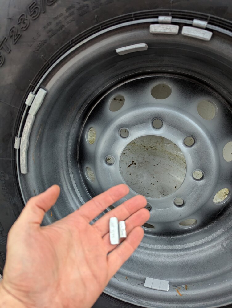

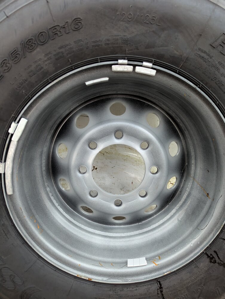

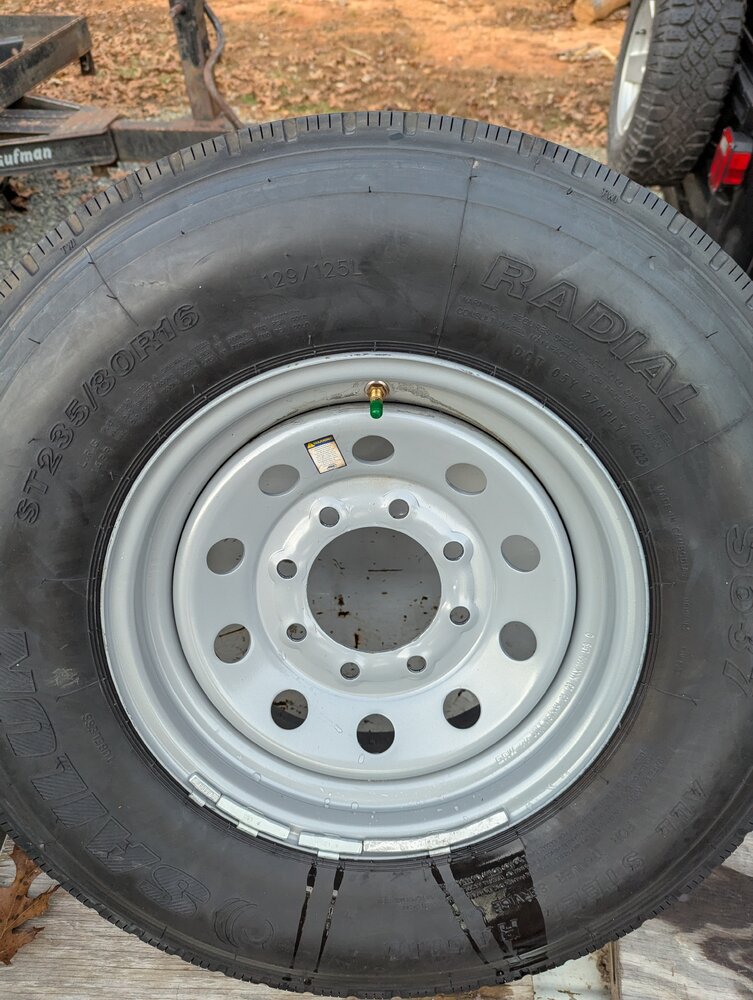

Well, I took the tires back to Mavis tire to get balanced....had a 20 min. argument with the manager about whether the tires needed to be balanced, he was of the opinion that tires only need to be balanced to smooth out the ride, and since no one rides on a trailer, they don't get balanced....he finally agreed to balance the tires. I can't tell if the people that work at this shop are 100% inept or if this was out of spite.
All the pictures are with the valve stem at 12 o'clock....almost every tire has weights on the back side of the tire that are 180 degrees from the weights on the front of the tire, every wheel has at least 6 weights on it, and when I was unloading them, a weight fell out of the stack.
This is my second time trying to get this shop to do the right thing, at this point, I am going to have to go with balance beads and leave a nasty review. They have already lost most of my metal valve caps and scratched the hell out of brand new wheels (yes they are relatively inexpensive steel wheels, but that isn't the point).

Those hammer on weights look like ones for aluminum wheels too. No wonder one fell off.
How can you tell the difference? It seems like every single time I have a tire "professionally balanced" they mar up my wheels with the weights, I didn't realize there were aluminum and steel specific hammer on weights.
Different coatings, shapes of the clip, and shapes of the weights. There's like 8 different types of weights, usually color coded along with a letter pairing.
