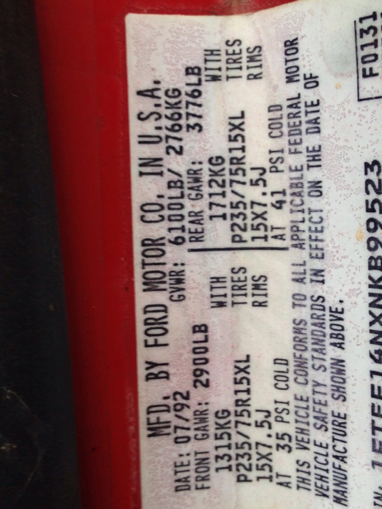

Well according to my truck it weighs 6100 stock
without going into that afore mentioned "can of worms" it's solid advice for a towing newb. Don't tow more than your tow vehicle weighs.
So a stock 2wd Dodge diesel can only tow 6500#?
View attachment 175960 Well according to my truck it weighs 6100 stock
That's not the curb weight of your vehicle, it's the most the vehicle is supposed to weigh, fully loaded with all passengers and cargo (more or less).
GVW is not curb weight, your truck does not weigh 6,100. My LB7 Duramax scales under 7,000.
