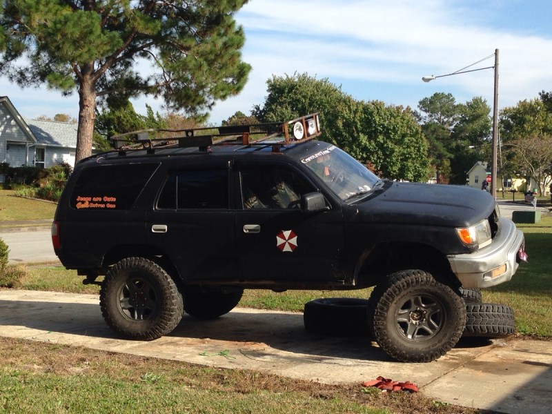

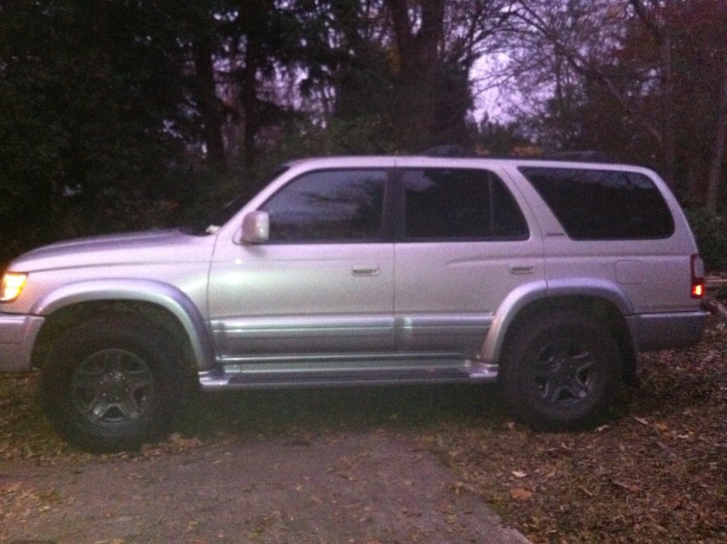

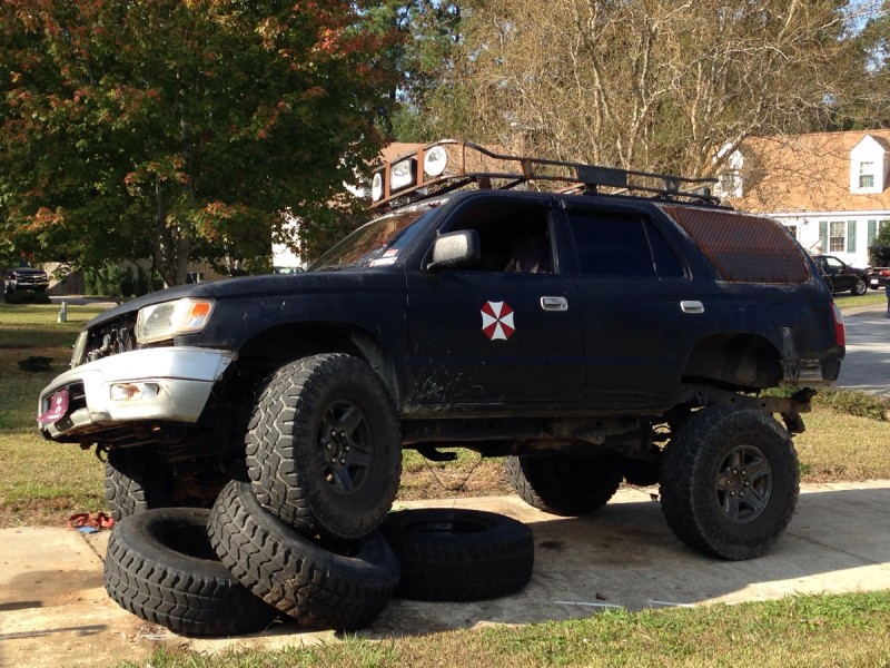

1999 Toyota 4Runner, 3.4L automatic. Started off as a 2WD with 265/75s.
Here she is now:
Things done:
4WD Conversion
DRC 2.5"
4Crawler 1.5" body lift
Custom transmission crossmember, lifting trans 1.5"
1.5" Engine lift
BudBuilt Clocking Ring
BudBuilt Front and Belly pans
Manual Hub Conversion
Spidertrax 1.5" wheel spacers
ABS Delete
'96 Tacoma 8.4" axle housing
4.88s
ARB Front and Rear
35x12.5x16

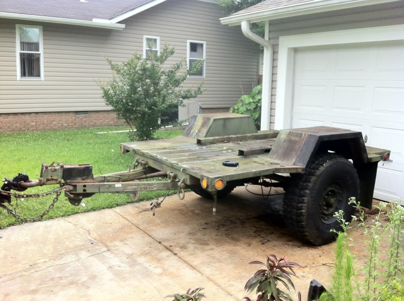

I've got this to turn into an expo trailer. Gonna need some modding to get that done.

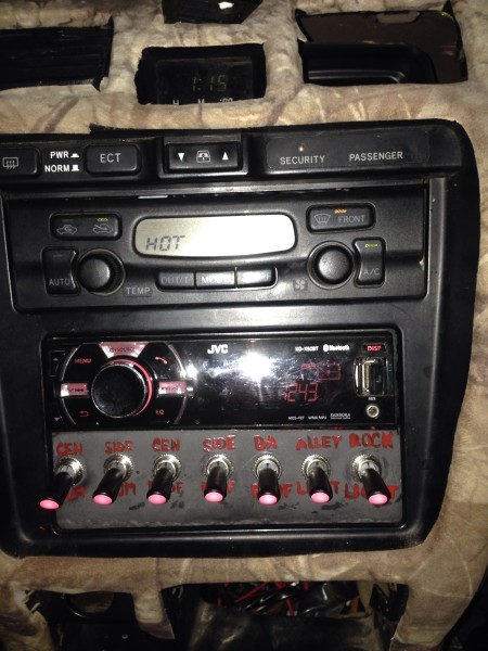

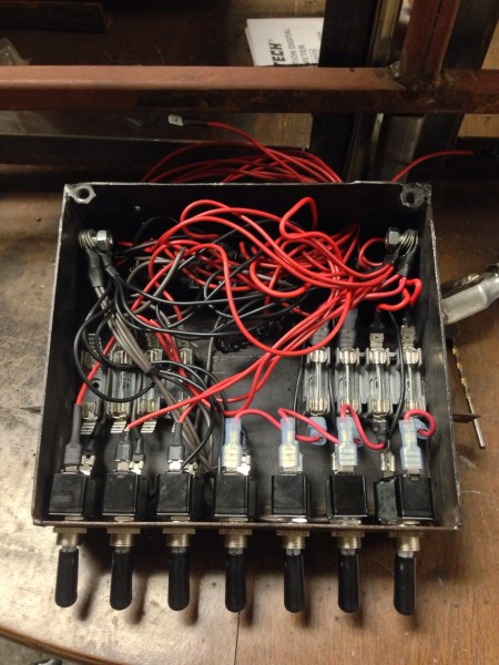

Made a custom switch box for all the lights I plan on running:
