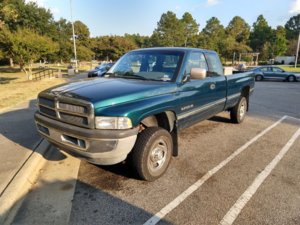

went and checked out two trucks today, a V8/NV4500 club cab, long bed, 4wd. The second truck was a V10/47RH reg. cab long bed 4wd....the V10 had a second gear slip, but was otherwise nice.
When all was said and done, I went with the 5.9l with a hand shaker! The price was right, she needs some love, but made it 200 miles he at 70mph.
