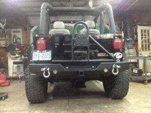

"DougBuilt" Check out this bumper Doug just built!!
storeman
Known by Few
Mar 8, 2007
Whiteville nc
Five of us down here went in together and bought a JD2 Tubing Bender. Doug built this Tire carrier bumper for a guy in town. He have also been doing some Roll bar work on my Jeep and others.
Looks good, just out of curiosity how much was the bender.
Right at $2400.00 but that includes the two dies we got. So just the bender with the pump was about 18 or 19 hundred. No good without Dies though.
We just ordered a Notcher from JD2 . The Notchmaster it is 275.00 the HF unit we bought for $49.00 is about gone.
