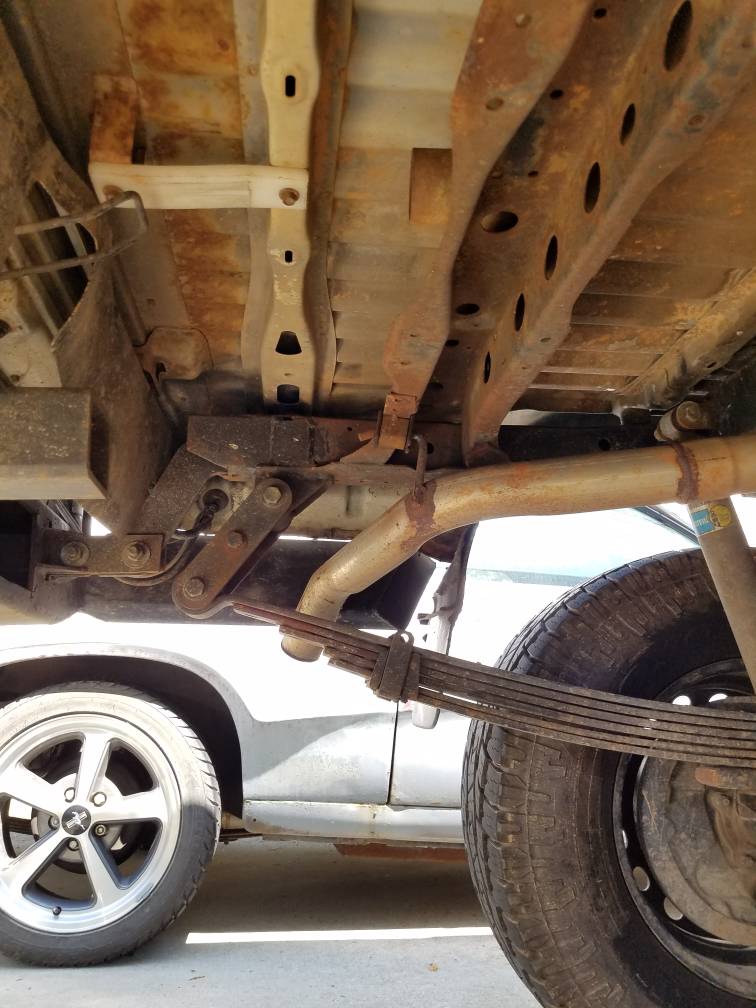

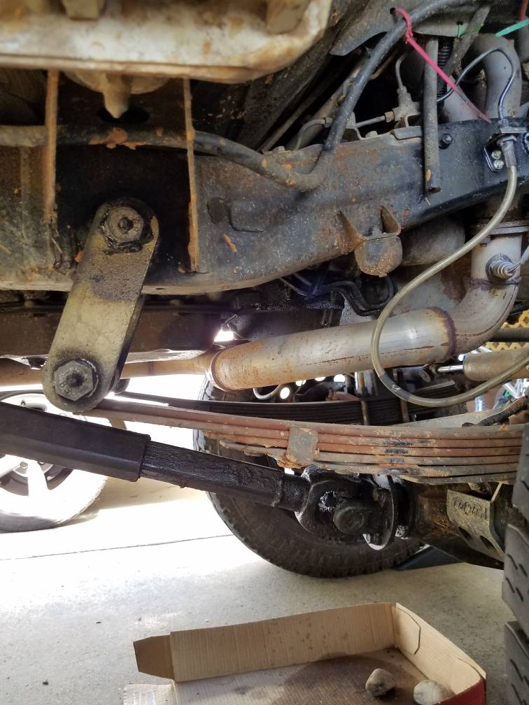

I'm not convinced you need a full 2500 pack out of a chevy for the rear. Maybe take one of the bottom leafs out? How is your rear shackle angle?

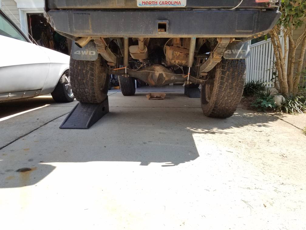

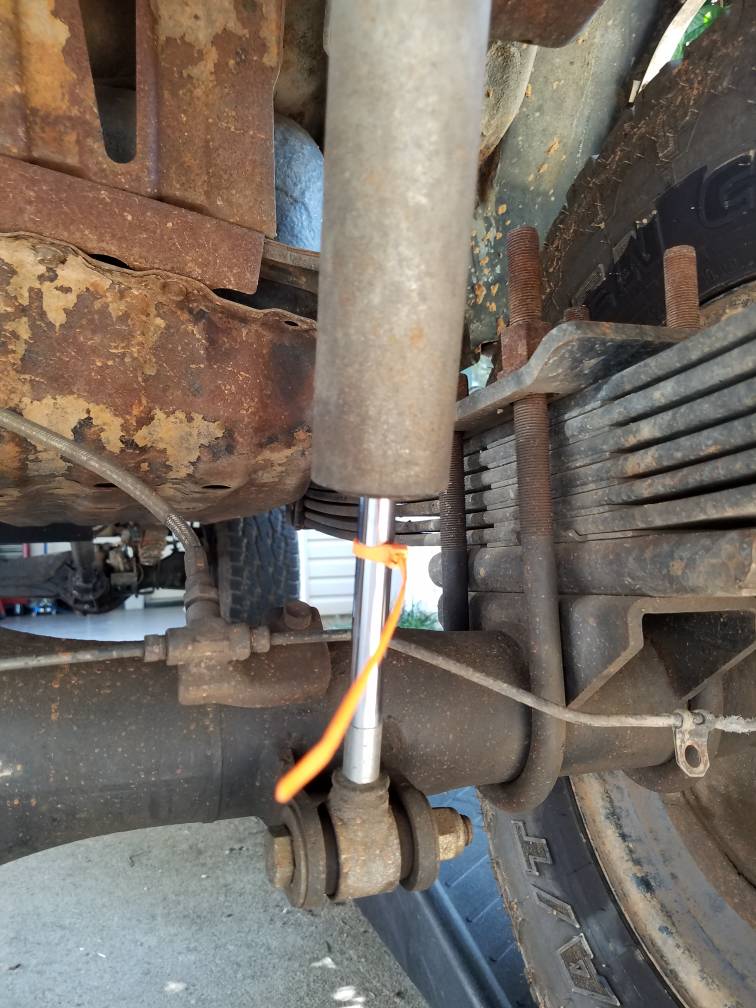

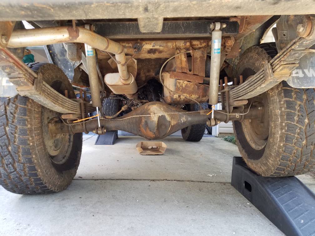

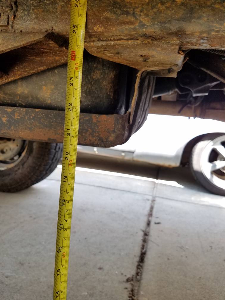

25" ground to bottom of frame just behind driver door. The driveway is not quite level. The front may sit level or 1/2" higher than rear unloaded.
Front shackle and rear shackle.

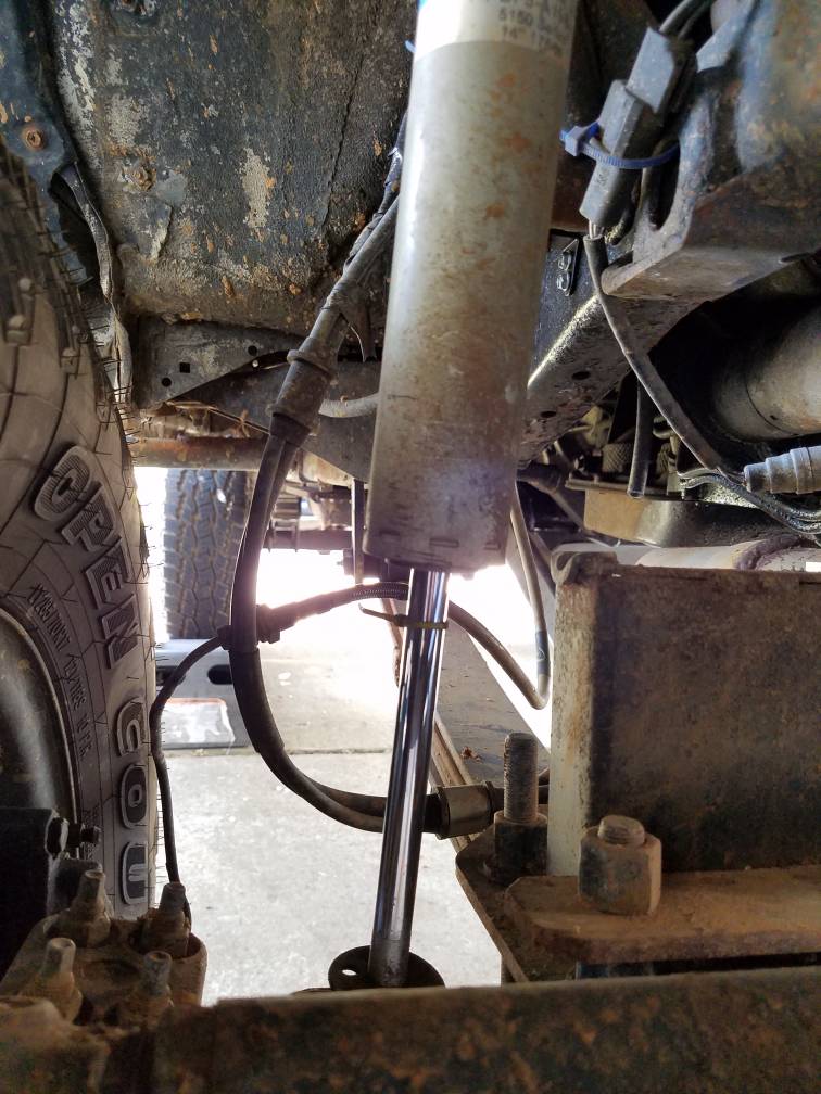

With me (160lbs) bouncing standing on the front and rear front bumper, both suspension compress about an inch.

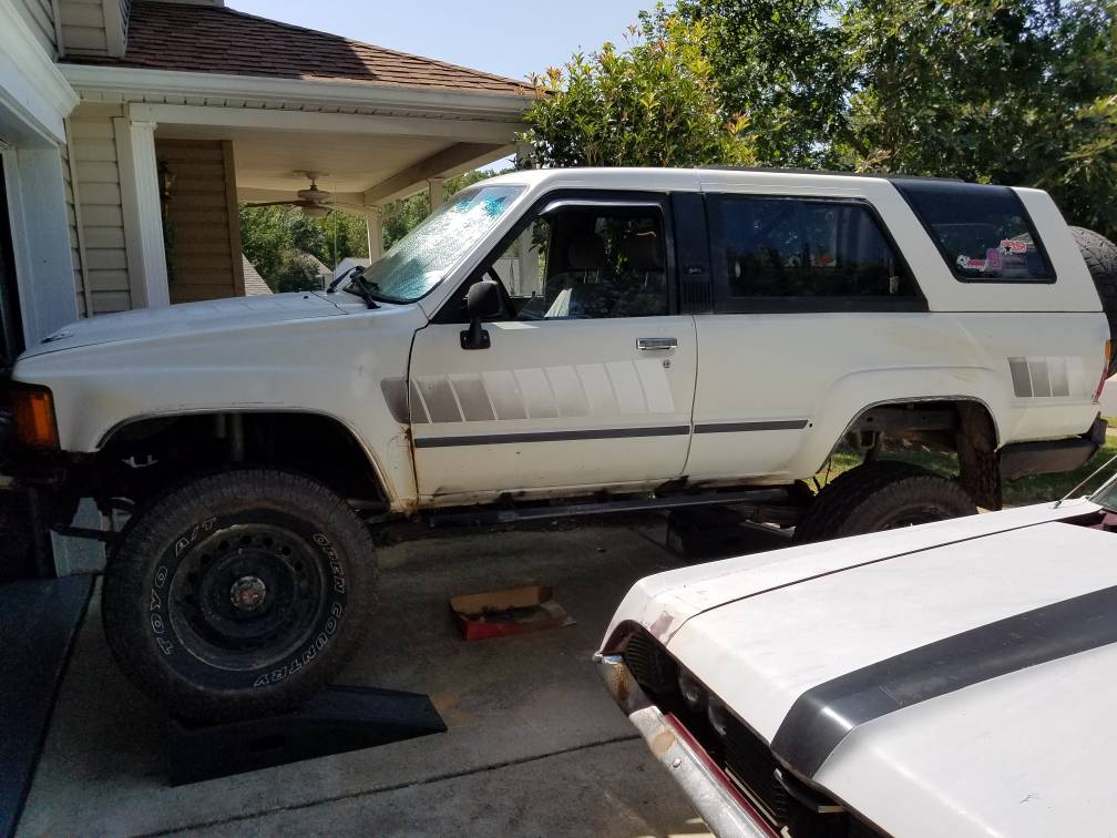

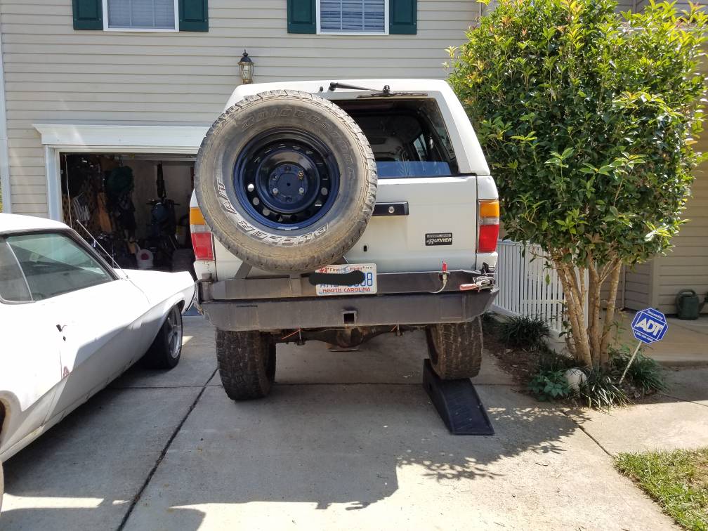

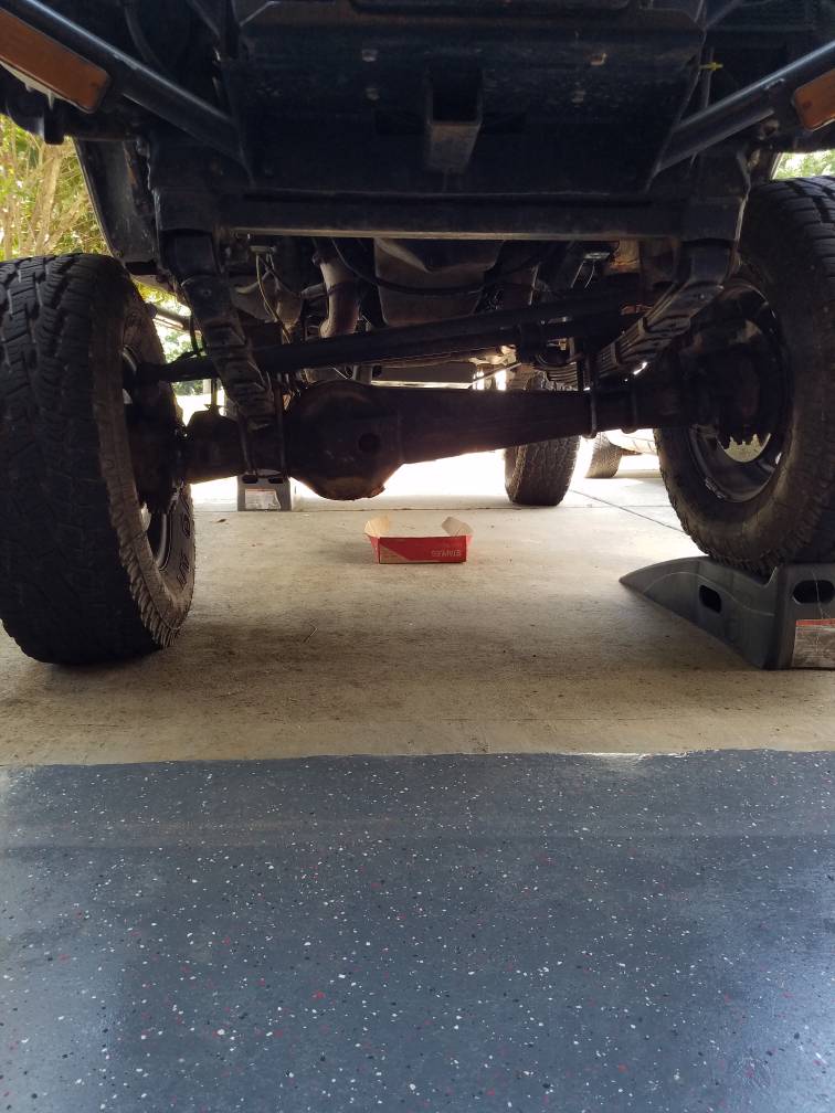

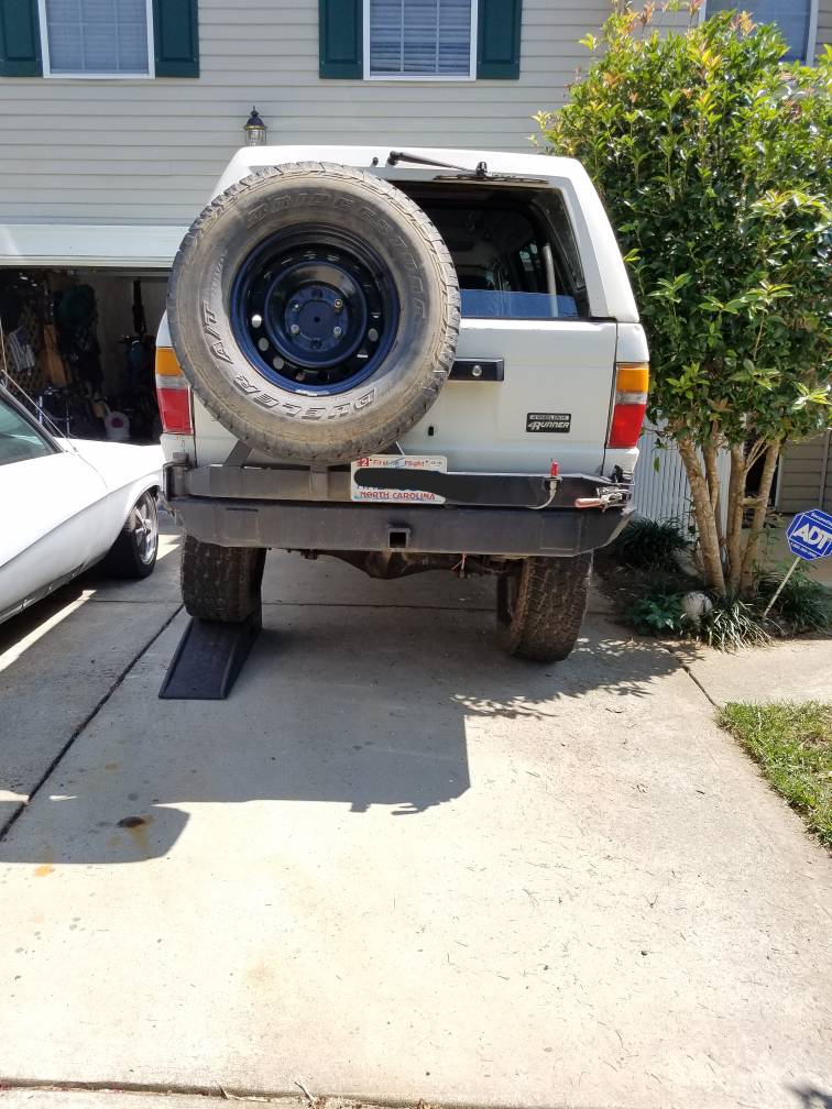

Staggered ramp on both sides. The body appears level from the front and maybe a slight tilt looking from the rear in each case.

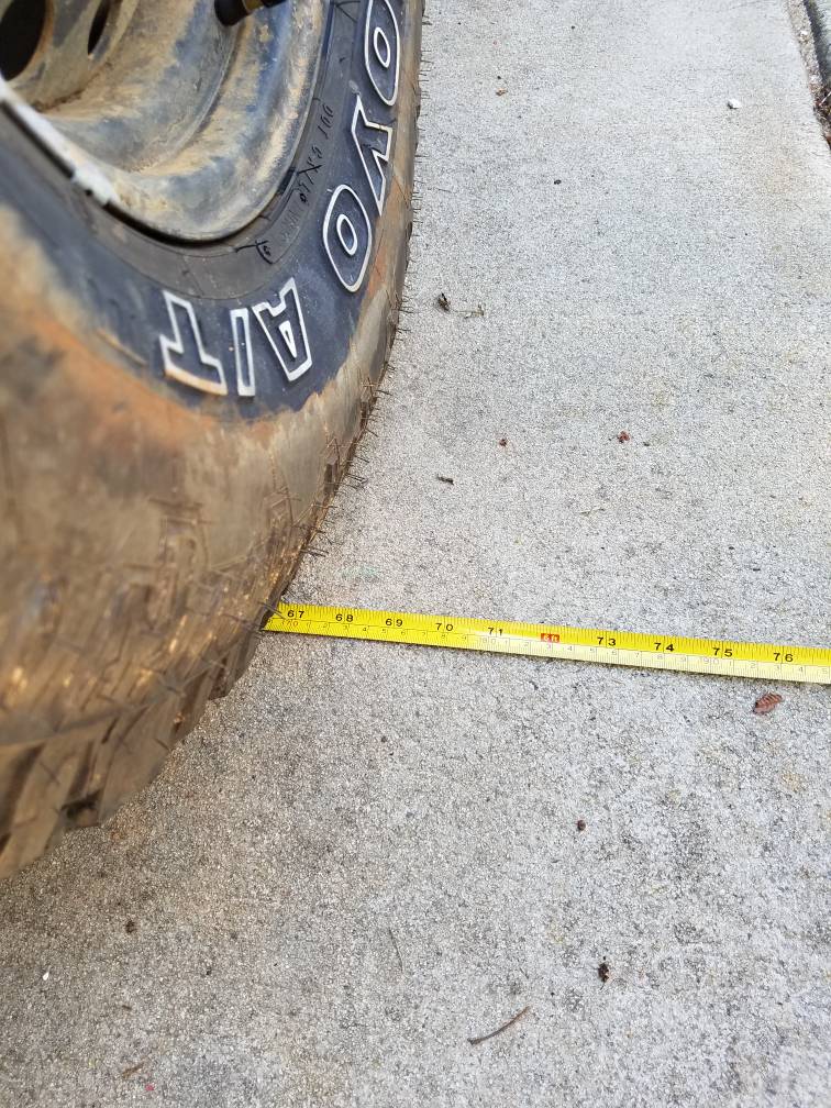

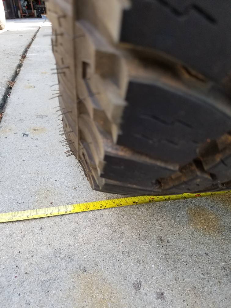

Track width to outside tread. I did remember I don't have the rear 1.25 spacer after switching to the wider 95 model rear axle.

The track width can also improve easily. I like the fj cruiser steelies, but may trade or buy something with backspace to gain atleast a couple inches of width.

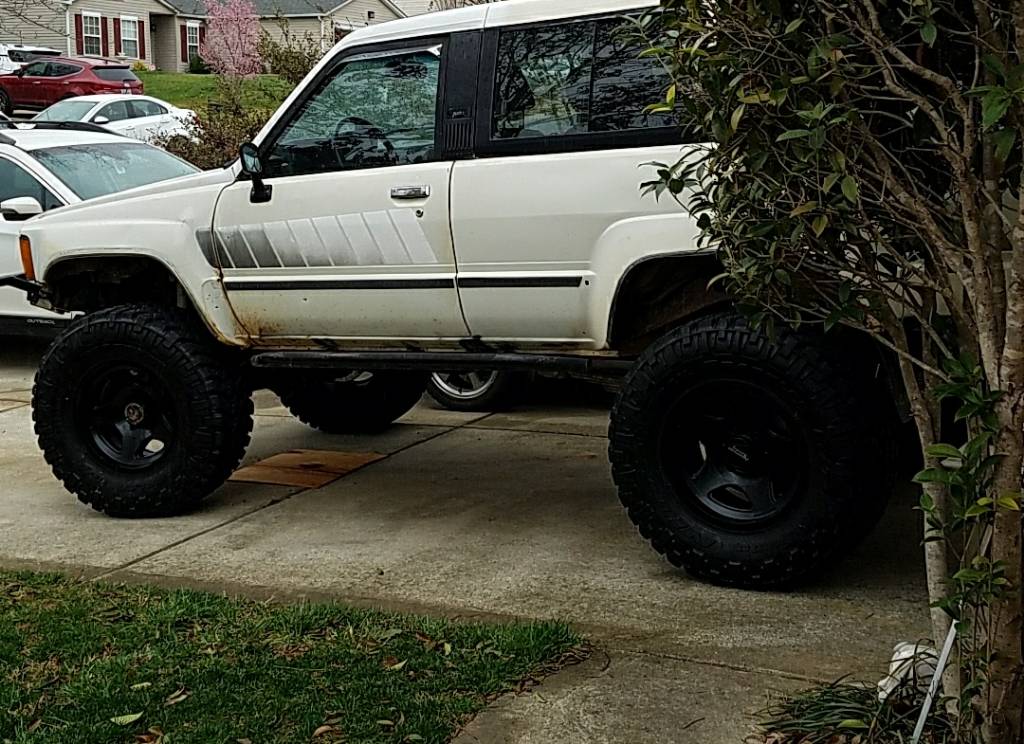

Sold the 285 and FJ steelies. Now on the 35 12.50 17 nitto trail grapplers in -12 offset 17x9 aluminum wheels.
Also removed a front leaf, so now back to stock 44044 springs. At the same time went down from TG 5" shackle to Barnes 4" boomerang shackle.
Road stability and ride is much better. Front and rear feels more balanced. Trying it out at the SHOP ride next weekend.
