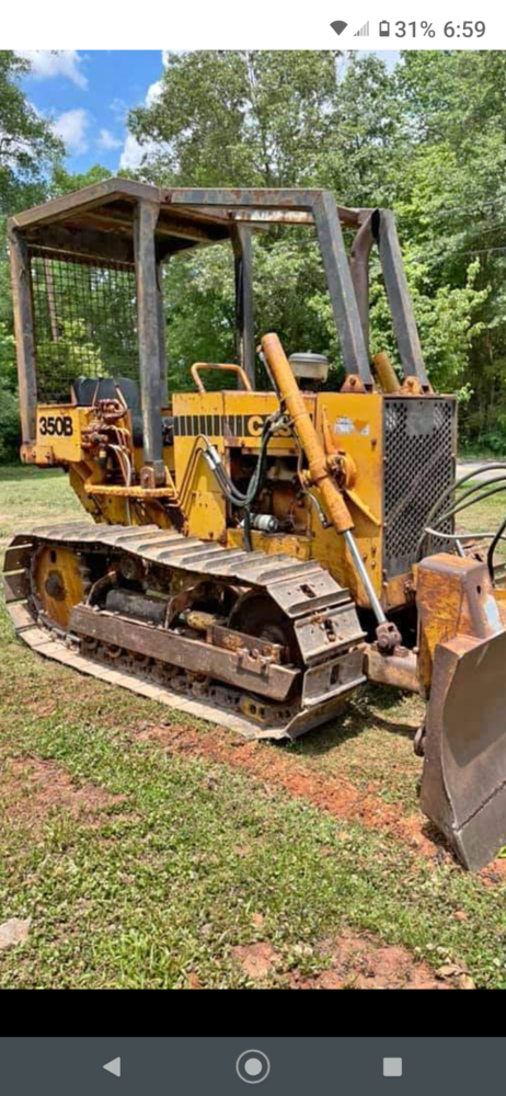

First is a nice little Case 350 that would be great making logging trails but I don't know about cutting 3-4' of grade.

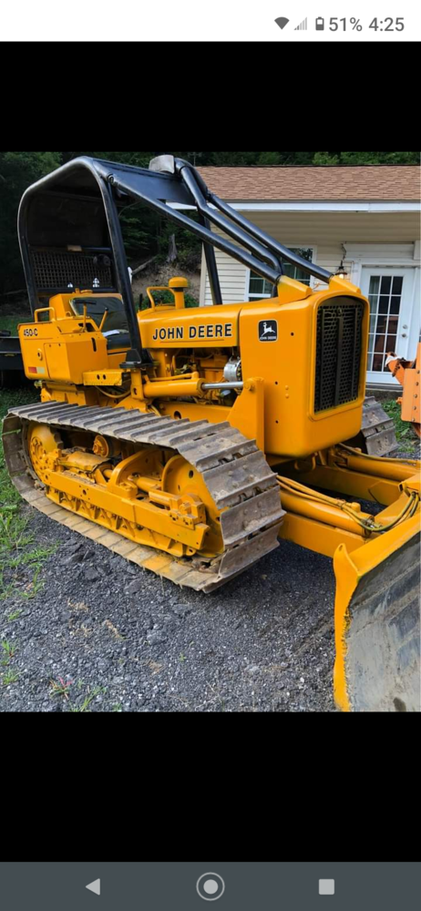

Second is a JD 450 but still the double than others trans cost spooks me.

I'd take the Case over the Deere because it still has original paint instead of a sprayover.

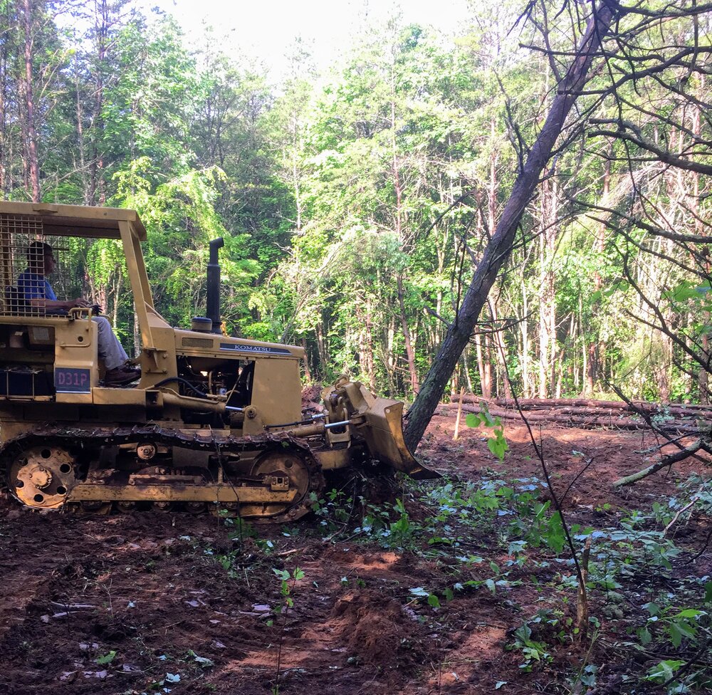

My Komatsu D21 was probably the best piece of equipment I ever owned. 9k pounds and will do anything you are asking with a decent operator. Small enough to easily pull behind a 3/4 or 1 ton truck. If you don't plan to move it, step up to something like a D31. Another to consider would be a Cat D3. I've seen a lot of D3Cs in your price range when I was considering another about a year ago, and they are a solid, well proven machine also.

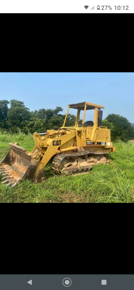

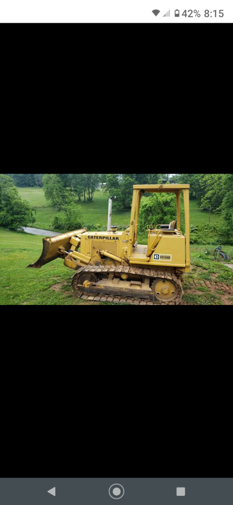

Here's a cat I've been looking into along with a loader that might work.
Both are 20k

Honestly with used equipment prices the way they are, I'd just do it with the backhoe you already have. No way I'd consider a loader with the backhoe already in the picture. But a mini ex and a tracked skidsteer would do everything you ever need, and a backhoe is kinda the compromise Swiss army knife to replace everything with one.

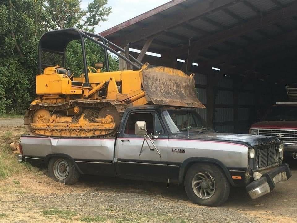

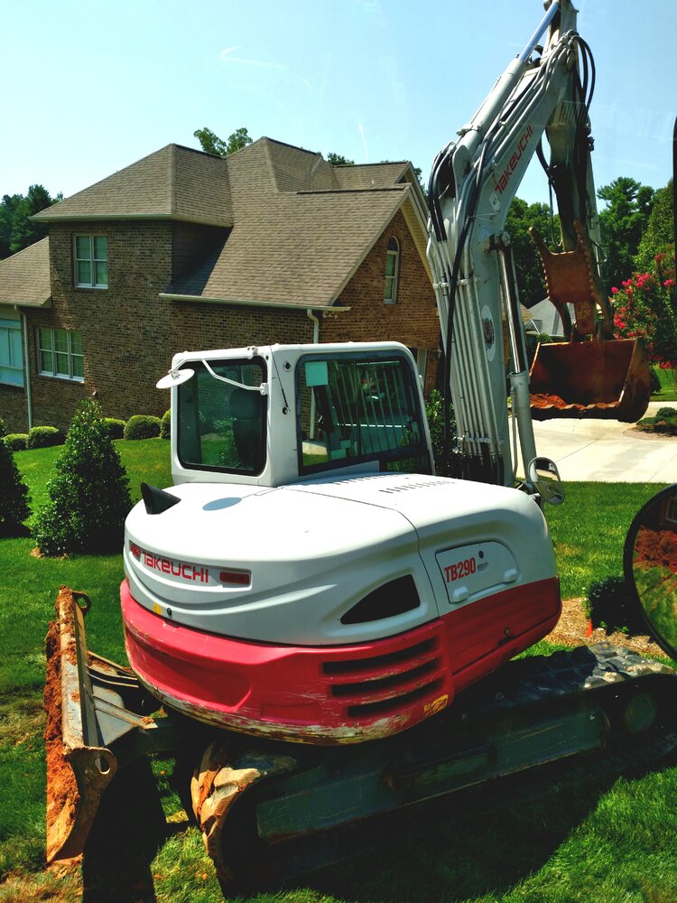

If you can’t pull it with a ton truck they get cheaper and if it requires anything bigger than a dump truck they will just about give it away.
A buddy got this after stopping and talking to the guy. It wasn’t for sale and guy couldn’t use it because he couldn’t move it
