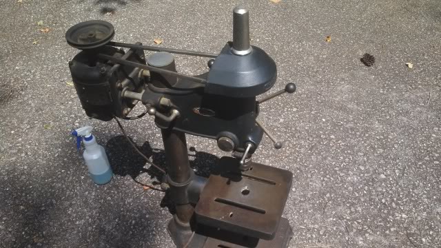

ai552.photobucket.com_albums_jj335_jrhxj1_IMG_20130910_124504_120_zps1216d83a.jpg I'll part with this one for $60. Would like to see it get used.

I am in blythewood sc about an hour south of Charlotte. And yeah its old lol but very sturdy, belt driven and torquey as all get out. 1/2" drive

View attachment 155850 I'll part with this one for $60. Would like to see it get used.
I picked got this old SOB today. It is big and heavy. However, runout looks like it will be less than a couple thousandths, spindle is true, everything runs smooth and quiet, and it is probably 2x as old as I am. I spent about 15 minutes cleaning it up and I am really happy with my new toy!
