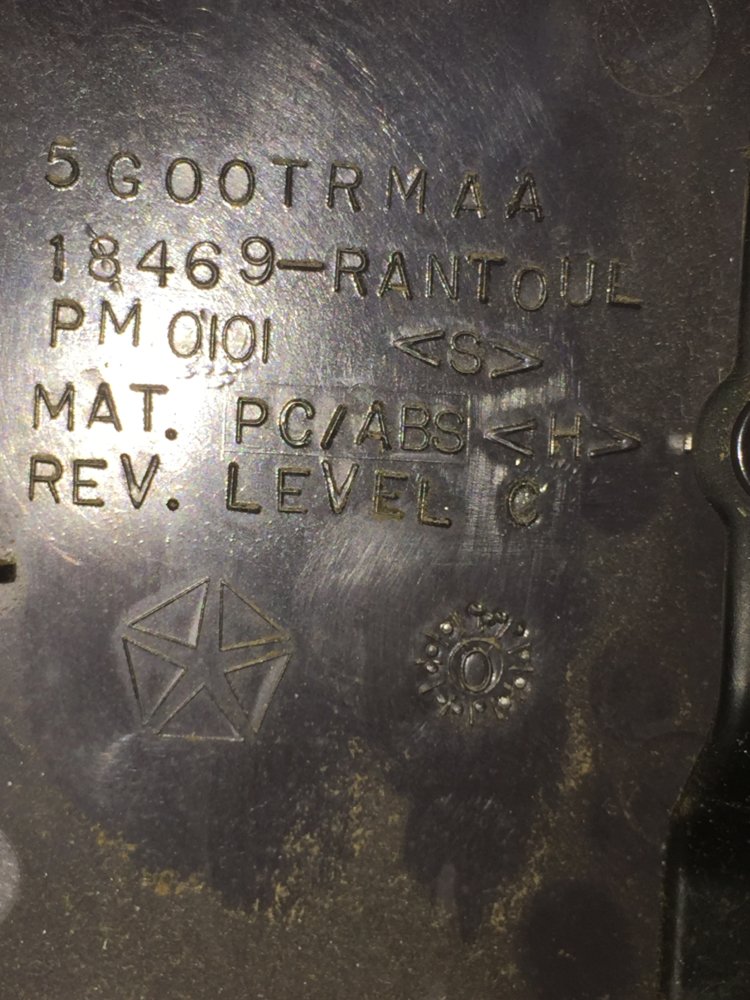

Tj column cover, that's plastic right?
Yes sir. PC/ABS according to the mold stampings
