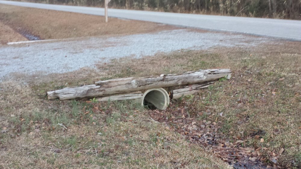

What's the best way to fix my driveways? Pictures to follow. I want to do new retaining walls, I guess you could call them. I'm thinking dig them out and build whatever I'm going to build and then backfill behind them. It probably needs to be able to keep the dirt from washing out between the building materials too.
As you'll see in the picture, my main driveway has telephone poles along the sides. They're ready to be replaced as they've served their purpose for just about 40 years. It's also very rounded up in the middle, so I'm going to scrape the rock back, fill in the sides, and then level it back out.
My second driveway will have another culvert added to make it closer to 40 feet wide. Not that it will make a difference, but I felt like mentioning it. I will also be adding another culvert and ditch crossing so you can get from the far driveway to the front yard for parking. So I will be doing a total of three driveways...I forsee this getting pricey.
What do you guys thinks? Suggestions for building materials? Pictures help! If I could get another 40 years out of them, that'd be awesome.

What do you mean rounded in the middle?? Is it high or low? Low is bad , little high is good . Referred to as "crown". Helps drive shed water and not run down the middle or puddle water. In my opinion it's all about the base.(not bass like the song). It's hard to beat ABC or crush/run or whatever they may call it in your area. I'm buy no means a drive expert but I have a 1 mile driveway and have some experience fixing one and have learned a little about what does and doesn't seem to work.
Through the years of it getting fixed, they just layered shit down the middle. If you get off the sides at all, it gives you the feeling of backing off the sides. A little crown is fine, but from the middle to the sides above those telephone poles is close to a foot. That's just too much.
On the first one, I would likely dig out the telephone poles and ~1 ft or so at the end of the culvert and pour a concrete wall back in its place. I would likely drive some rebar deep into the ground first and tie a few horizontal to help everything stay in place. If it is holding now, I dont see the need to dig out the base and completely redo; just remove the rotting wood and rebuild to keep it from washing.

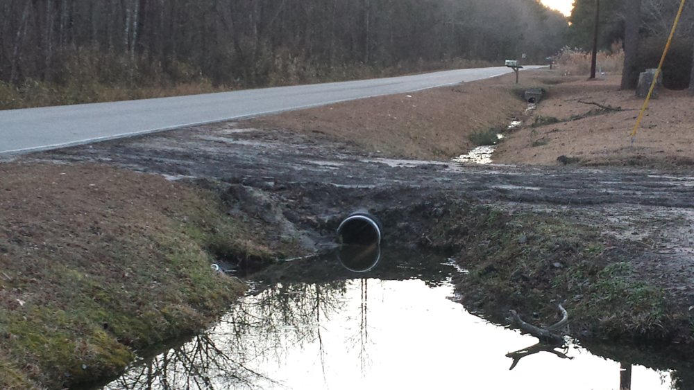

I would likely do the same on the second one, but not exactly sure what is going on at the close end of the picture? Is the ditch just washed out, or does it turn into some retaining pond?
It's partially washed out, but that's where the other piece of culvert will be and it will get covered to widen the driveway. There's a culvert coming under the road that you can't see and to the right is a ditch that runs through my property.

Was the wash out due to a 100year rain storm or run of the mill afternoon thunderstorm(s). Might need bigger culverts if the latter

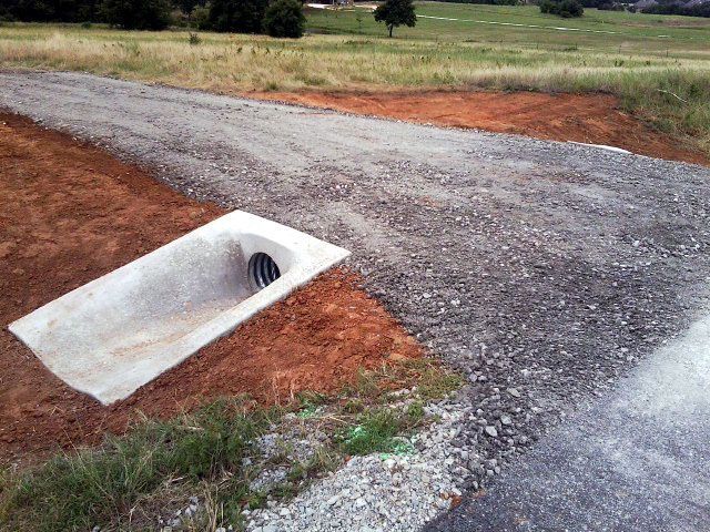

Gonna take a pretty Stought wall to hold up & not move. Concrete blocks or RR ties, aren't gonna help much. Grave/ Stone, moves with traffic, & sinks too. Centers always hump up, but you can keep leveling the centers to the sides, so you don't end up with a foot of fill towering over the sides. The wider, the better, because it will be more natural to drive towards middle, & turns wont be as sharp. Fast turns & sharp turns, pushes the material to the side. I think I like the Aprons. Look up Culvert Aprons, & get more ideas than you need!

The only reason the second driveway looks like it does is because that part of my land was just cleared and I had the guy dig up the old, busted, concrete culvert and put that one down. There wasn't previously an issue with washing out, but that's the lowest point of the ditches from either side, unfortunately.
There's literally no way to fix the water runoff without getting the Army Corp of Engineers involved. They funnel water off of the power lines across the road and throughout national forest land right through my property. Nice, right? Everything flows fine and doesn't wash out when it's packed.

Either of those ideas worth a damn? I like the aprons too, just not sure where I can find them around here.

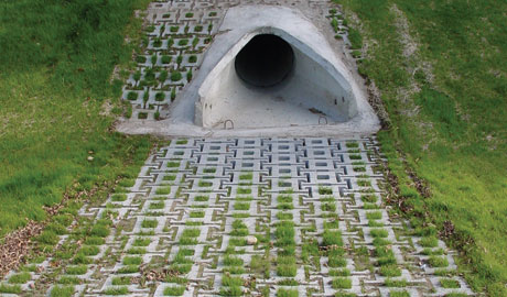

Use these, slope your soil more gently, and seed or rip rap them. Put a post close to the end to keep people from running off of the edge. These are pre-made products just for this.

I would personally stay away from rail road tie retaining walls. You are either buying new (don't know if you even can) or pulled ties with a questionable life span remaining. Those ties will deteriorate at some point (quicker with the second picture and standing water often-ish) and have to be replaced. If you are building a wall correctly then that means digging up your entire driveway to redo it. I would go block or sloped
