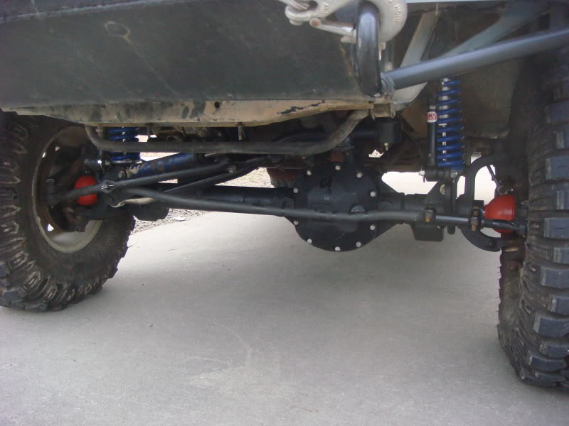

Here are some current pics and specs. I hope to test out the new suspension in a few weeks, once finals are over.
Specs:

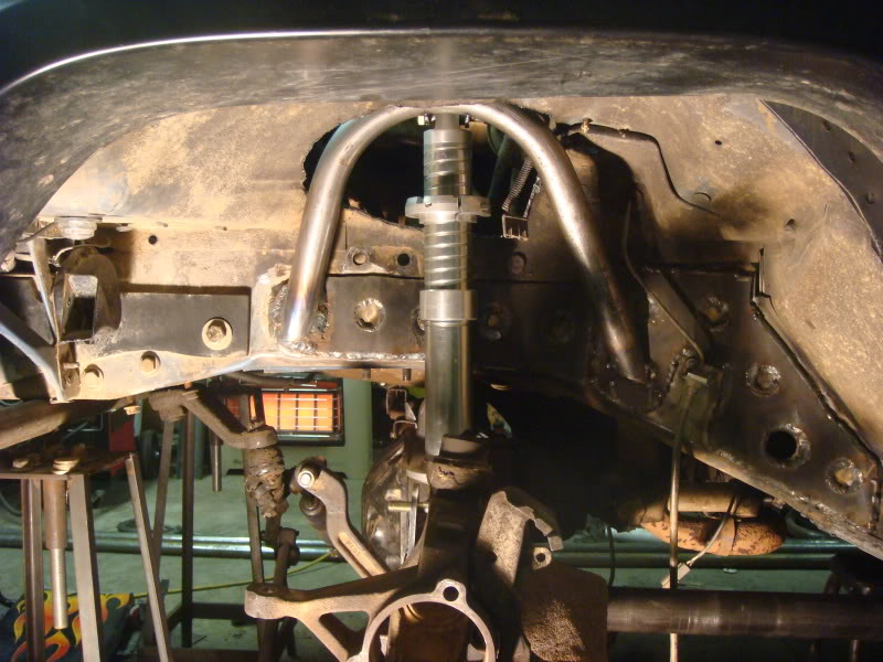

Front suspension is a 3-link with FOA 2" coilovers, the rear is just a Rustys 3" spring pack. Everything sits at about 4.5" over stock.

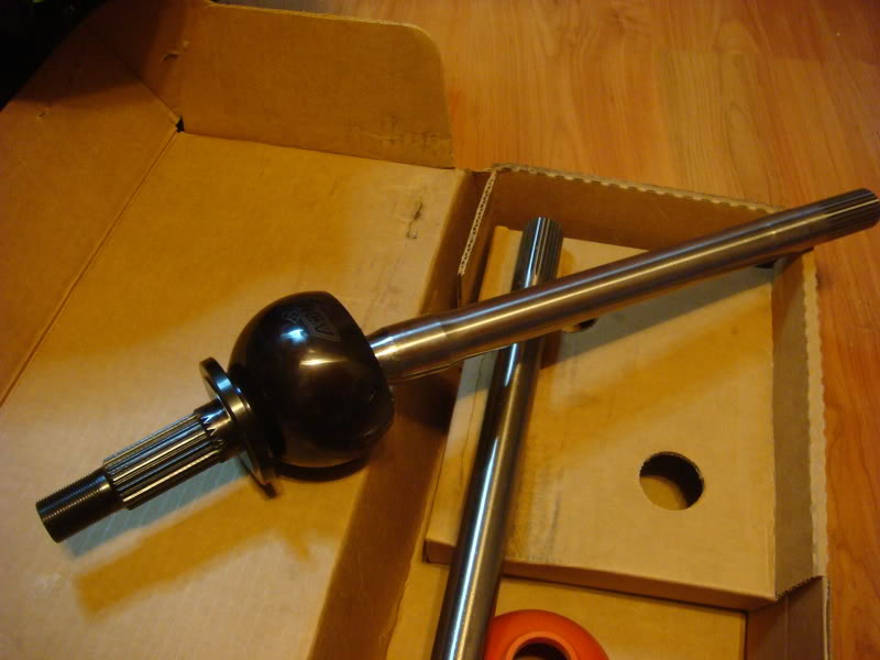

For axles I am running the D30 up front with an ECTED locker, 4.56 gears, and RCV shafts. The rear is the D44 that came in it and it has an ECTED locker and 4.56 gears also.
It also has the brake booster and master cylinder out of a 2000 Grand Cherokee. The bumpers, rock rails, exocage and tube doors were all built by me.
Pics:

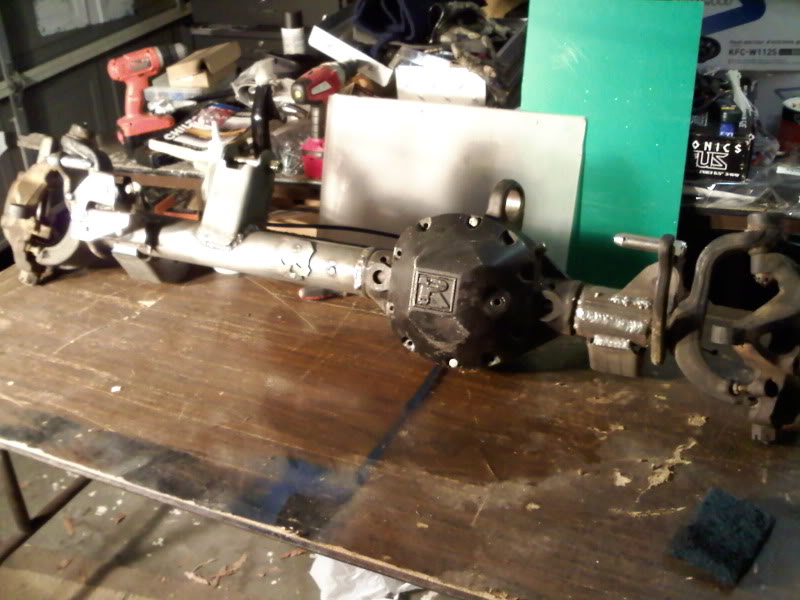

Cut the d30 appart to get rid of the vac disco unit, and sleeve the tubes with 3"x.250" wall DOM

Seems like a lot of money to spend on a d30. Why not just up grade to a d44?

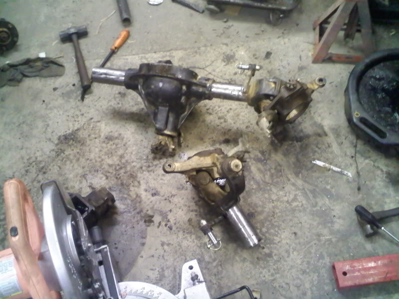

:shaking::shaking::shaking::shaking::shaking:
wow, talking about going around your bunghole to get to your elbow. thats a lot of work to get rid of a disco that all you had to was swap into TJ shafts and make a block off plate.
OR....am i missing something?
The reason that I built up the D30 was because I don't plan on anything bigger than 35's with this rig. If I do ever go any bigger I will most likely be out of college and have a real job with real money where I can build some nice big axles. The D30 was already locked and geared when I did this to it, so no point in buying a new axle and re-gearing and locking it. With the RCV's the D30 will be plenty strong for me.
The reason for all of the extra work to get rid of the vac disco was because I built a 3-link, and you can't really mount a heim joint to this big cast piece. Sleeving it also made it stronger than with the cast piece.

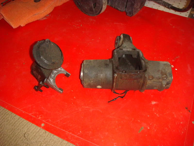

Here is the disco part, you can see that you can't mount a heim to it.
Hey I'm not hatin'. Part of the fun of doing all this is modding it yourself. Personally though I would have just swapped in a non-disco D30 and swapped the gears and locker. Yeah you got another R&P setup to do, but seems like that would be less work than what you did here. However, nice job and it looked like fun. :) :beer:
