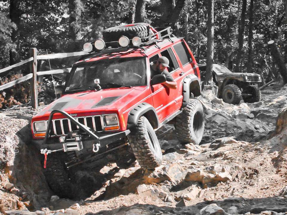

Ditch the idea and throw your spare on the roof.
Before
After
I put the spare on the roof ONCE! putting it up was not fun when it was a 31" and getting it off was scary at best. i also don't like the added weight up high. not looking to do that again
Well, if you're going to mount it on the back, put it as high as possible.
And I was able to get my full size 35" spare on and off the roof by myself, not saying it wasnt sketchy, but it's doable.

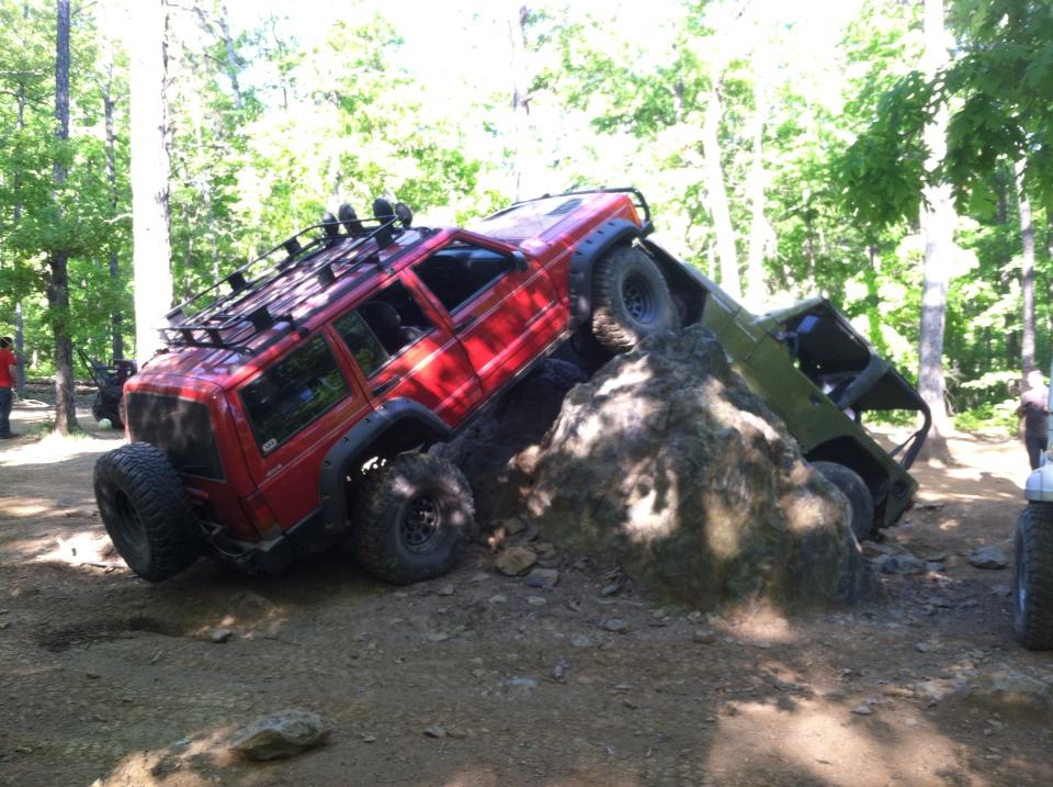

I have wheeled my old ZJ with a tire in the cargo area, tire on the roof, and tire on a swing out tire carrier (no, not all at once haha). All had plenty of pros and cons. For me, a unibody rig is already top heavy and getting a tire on the roof was a real PITA especially if you were at an angle when you needed said tire. Inside took up too much cargo room (but now having a TJ, there was still plenty of room in the ZJ). Swing out tire carrier is where I ended up. I did drag the tire a few times, and opening the hatch when on a side angle sucked but in the end it was worth the hassle.

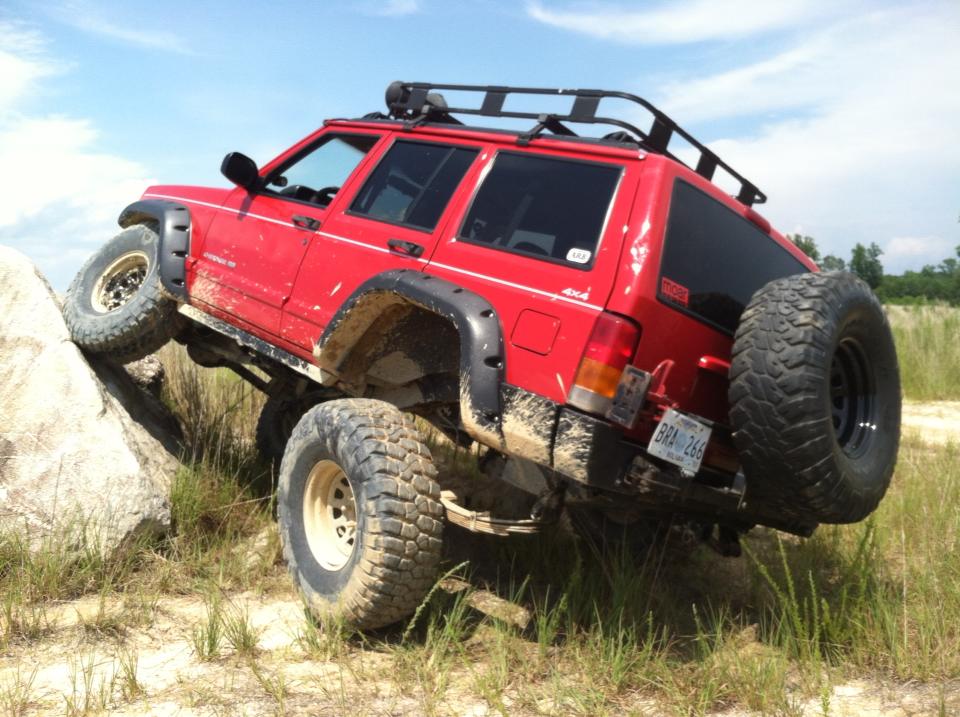

Best picture I have to explain. It barely missed rubbing the ground here, but it rubbed on the 1st and 3rd ledges at URE on Daniel. Basically I'm cautioning the OP to mount the tire as high on the swing out as possible, so it won't contact the ground. If it does hard enough while moving forward, glass goes everywhere.
