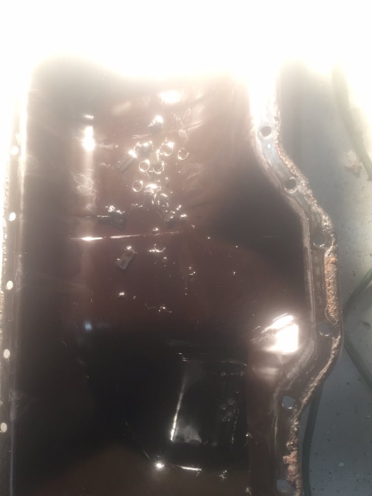

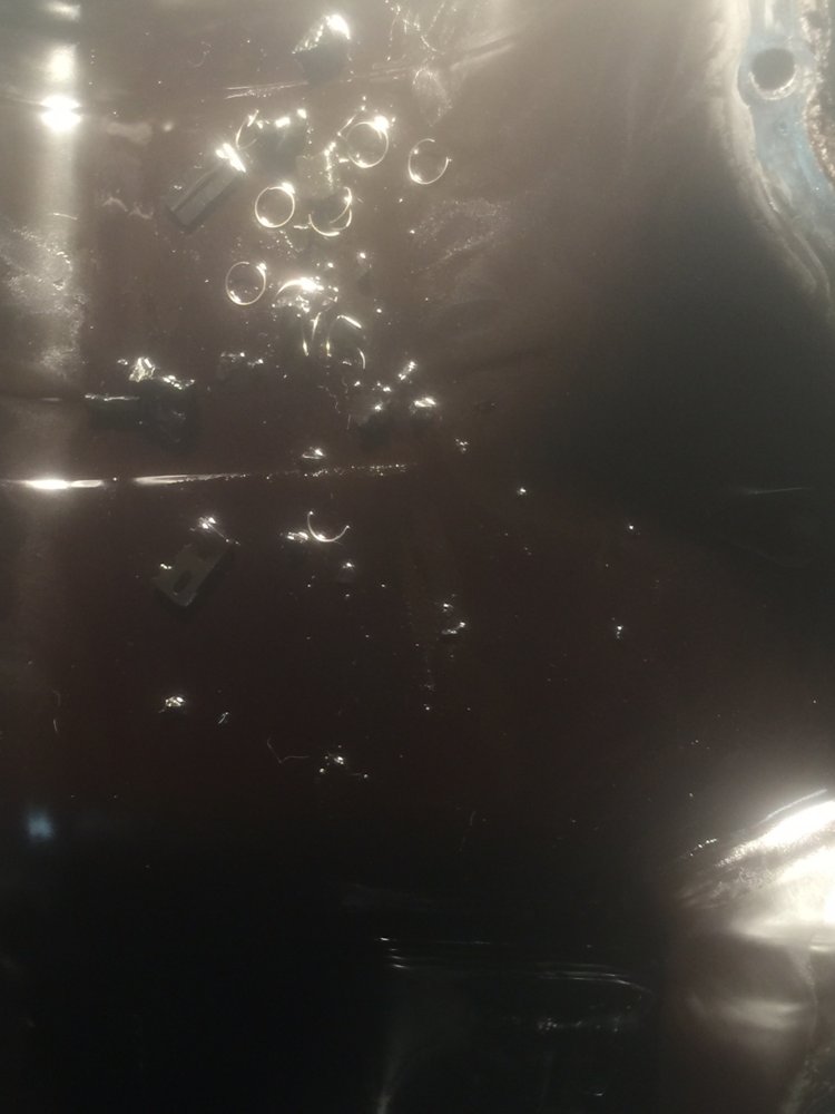

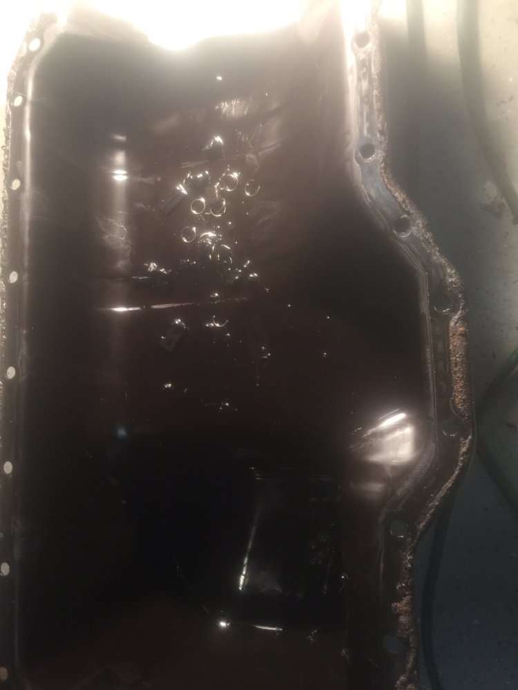

So, I've been taking in small things I can try to do myself. This time it's the oil pan gasket and rear main seal. I found out my TJ is a one piece, so yay on dropping transmission this weekend. However I noticed this pieces down in my oil pan as I was cleaning it out. Would anyone know why the hell they are? Some looked like broken springs and the others were black plastic pieces. Should they be cause for concern?

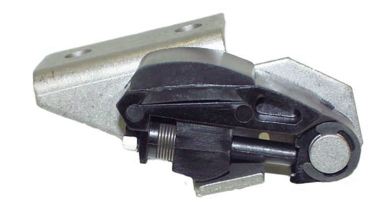

Does it go tap tap tap from the front cover at idle?
Make sure to replace the chain, which will likely be worn if the tensioner has been failed for a while. Also check the crank and cam sprockets for wear. Slack timing chains tend to eat themselves fairly rapidly. On the plus side, the chain must be intact (because the engine runs) and you would likely know if it has skipped timing.
Yeah, but depending on the vehicle history, I wouldn't be surprised if a PO replaced the chain and/or tensioner and didn't drop the pan when they did the timing work. Without the tensioner, the chain will slap the front cover at idle (and will eventually wear a hole in it).
If the pan is still off, you should be able to see the tensioner. It's down near the bottom, just to the side of the crank.

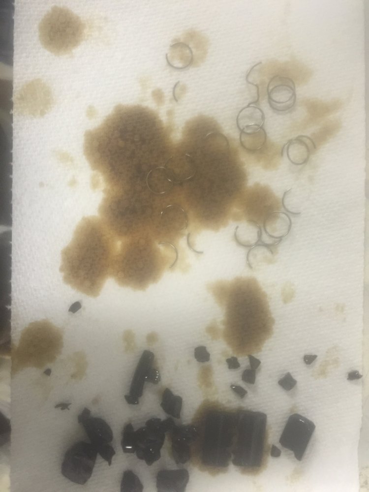

Can't really see anything in any detail in the pics you provided. Do you have any better ones?
Is this better?

Thanks y'all! I will check that after we drop the tranny for the rear main seal. Might as well do the camshaft seal since I'll be in that area.
Great call fellas! After further inspection, tensioner was gone! Chain cracked the damned cover and was loose as hell! Gotta order cover before everything goes back in. I appreciate the help!
