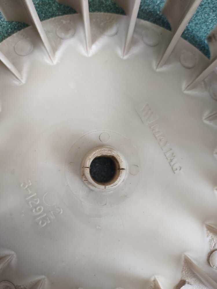

Came to realize the squirrel cage on the front of the shaft was spinning/wobbly on the shaft.
The plastic D center had worn out, allowing it to slip on the shaft.
Apparently you would mostly spin with the shaft, but if there was any friction then it could slide along it making noise.
With nothing in the dryer there just wasn't much friction, but when it was loaded it was just enough wobbling around of the whole assembly that it would add just enough friction for it to rub and make noise, echoing down through the lint chute sounding a lot worse than it really was.
