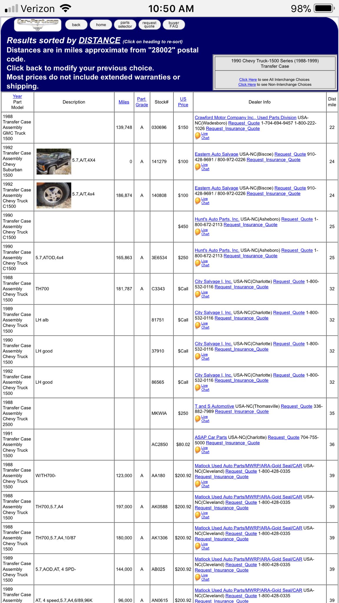

Search Results
Car-part.com is awesome.
Yes Any late 80s early 90s Chevy 1500 truck / suburban would have had it.
