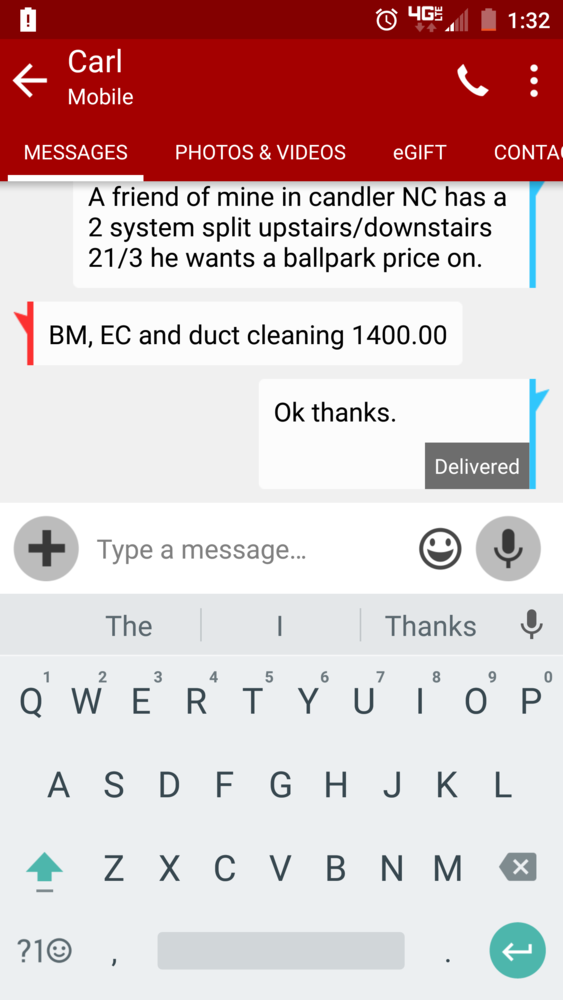

Let me dig through my paperwork. I'll get you within $100 or so.
That's if I (with another well experienced tech) comes from Lexington SC to do it.
Package unit or split system?
@XJsavage not sure what BM and EC is sorry no experience in the HVAC field.
Blower Motor and Evaporater Coils. That as we call it is a "full system" cleaning. We pull and disassemble both blower motors assemblies and give them a good pressure washing and then reinstall. The coils inside the unit and if need be, the outside condenser coils will be cleaned with a fine tooth comb.
You can probably find cheaper locally but I can assure you it wont be the same quality.
