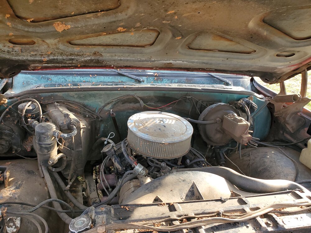

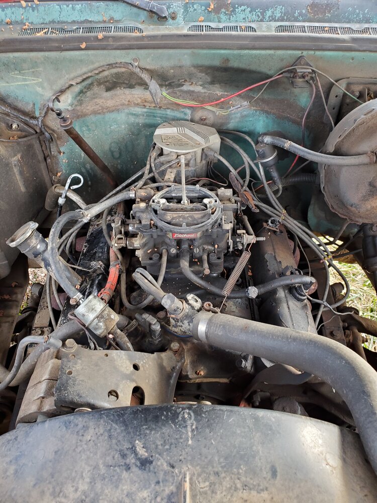

So I've looked online, and haven't found a solid answer. I'm running new fuel line on my 87 C10. Going to an edlebrock carb on a mildly built 350. What size line? Engine isn't anything crazy. Slight bore and a towing cam. Also, what does everyone suggest for a backflow valve? IE, to prevent gas running back to the tank warn the truck is not running.

And no check valve needed. The float bowels will hold fuel to get it started and the pump will be refilling the carb long before they run out of go juice.
Ok. I've had to bottle feed it to start ever since I bought it.
Should be gas in the bowel. I’m no carb expert so maybe someone will chime in but maybe check the float and needle to make sure fuel isn’t pushing past it due to getting hot and expansion?? Edelbrocks aren’t hard to pull the top plate off to get to the guts.
Should clarify, I have to drip feed it gas when I first crank it. I'm no expert either, especially woth edlebrock.
Sounds like something is not working right. With it off if you look down the carb hole when you hand crank the throttle is there gas squirting in? Also does it stumble on acceleration?
No, and yes.

A "good" Holley? lol Seriously though, that carb can be rebuilt and that would possibly fix your issue along with replacing your fuel line if its a problem. If you have some spray when working the throttle then the bowl has fuel in it. Theres a carb guy that will rebuild your carb or send you a rebuilt one when you send him your core. I'll try to find him and send to you
Years ago, when most everyone was running carbs, and I was too. I had the same issue has what you are describing. I patched by raising the fuel in the bowl by adjusting the float, helped but didn't fix it. So me at the time knew little about carbs, I bought a cheap fuel pump what would allow fuel to flow though it when it was off (pulling fuel by the mechanical pump) When I went to start it, I would flip a switch giving the electric fuel pump power, hit the switch and start the engine, and then turn off the electric pump until it was needed next. That was on a qaudrajet carb, the edlebrock is less involved. You can pull the top off with it running and see what's going on. Could be something as simple as some build up of trash or bag gas, for sure, it's something between the needle and seat and the fuel inlet.
