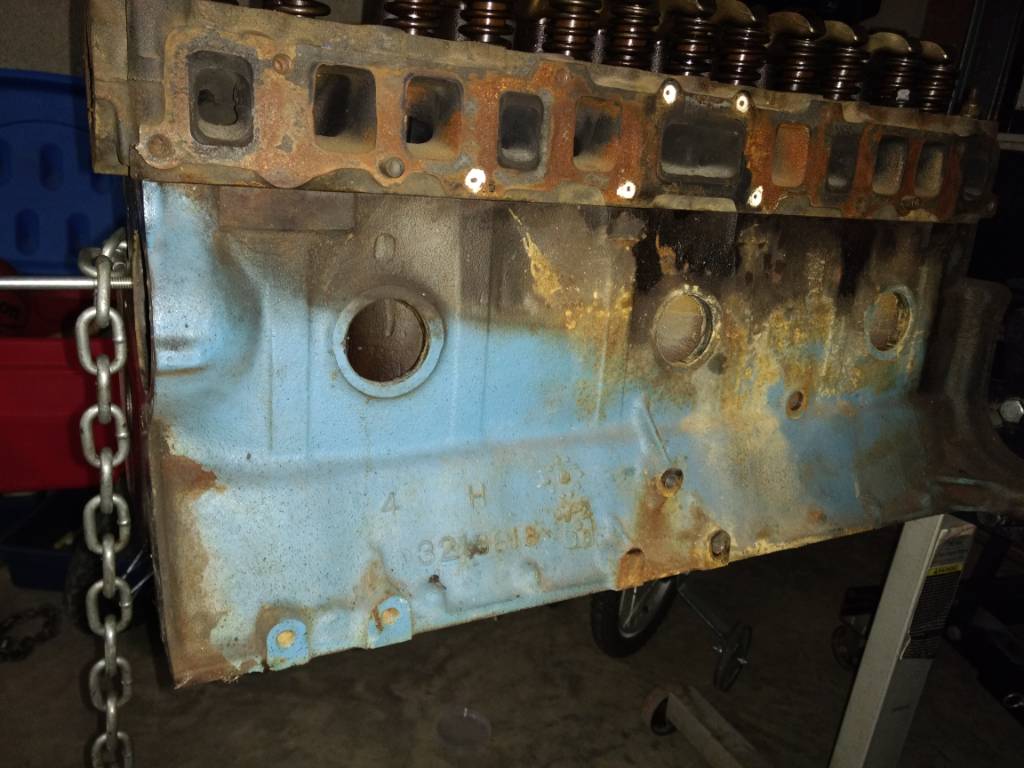

Had a good 78 short block i planned to swap into the 84 cj that i I picked up. Pulling things apart and I notice that there aren't bosses on the early block for the power steering bracket. Anyone know of a fix for this, or am I stuck using the newer block. That will involve a fair amount more money and I'm not interested in that.

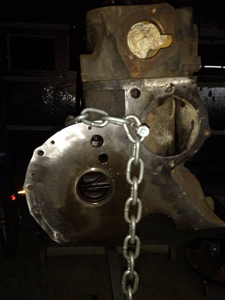

Thanks. After speaking with another friend, he thinks that the one I have may have started as a 232. I have to move on to find another. The timing cover is different as well.

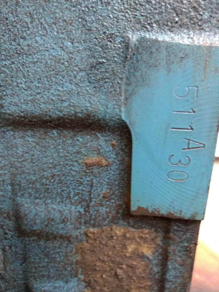

Check the number on the side of the block. The letter in the number will tell you if its a 232 or a 258. Just going off of memory here and my books are in a very cold shop right now so I maybe alittle off but I think:
A=232
B=258 one barrel
C=258 two barrel.

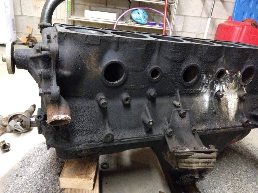

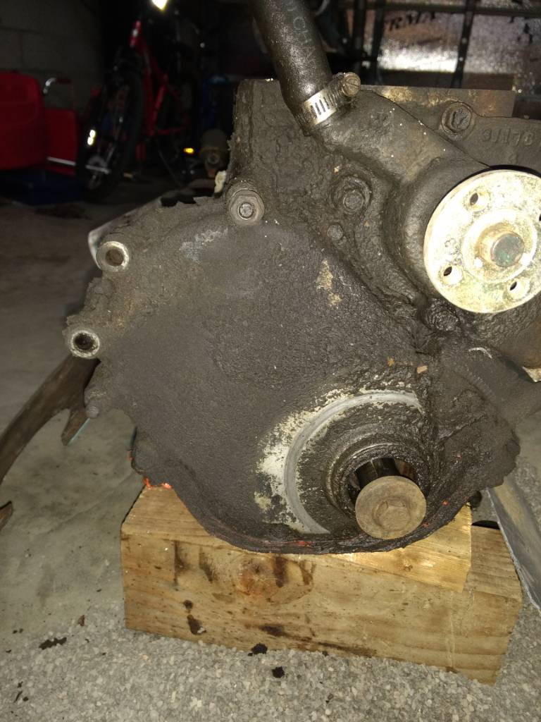

You can see the difference in the pics. The first one is the newer engine I have. I dug through pics on Google today. Learned that there were several different castings.
