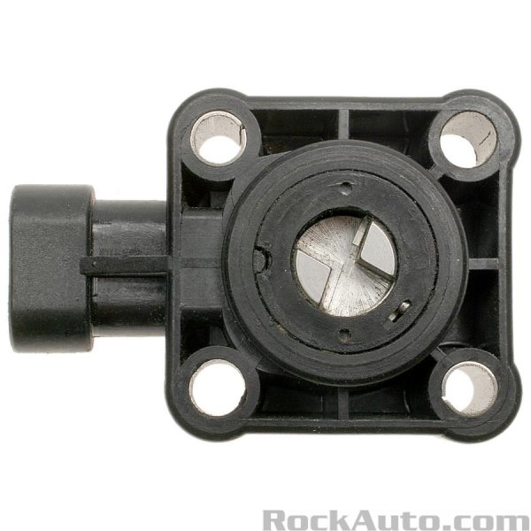

TPS input = Stock P-pump (NEW Napa, see pic)

right off the bat my TPS isn't working...
-time to brake out the new one.
-Put that in that AND
-found a wire that had spaced it self out off the connector
-a simple little fix BALM we had a working TPS
