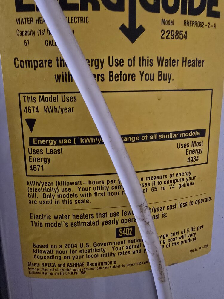

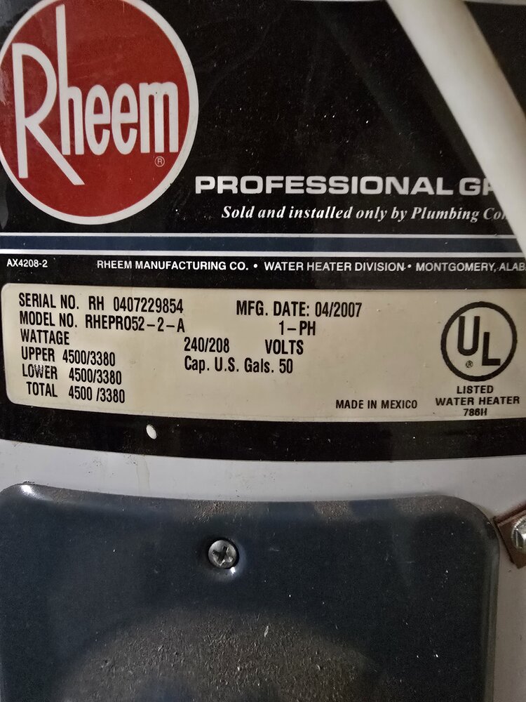

Looking for Electric water heater recs. Parents heater is going out according to Morris Jenkins and they've got my parents sweating with the numbers for a replacement unit. $4,000.00 approx, which is the middle price option. Their little quote sheet didn't have any makes or models; just Budget, Premium and Premier (go figure) with price points.

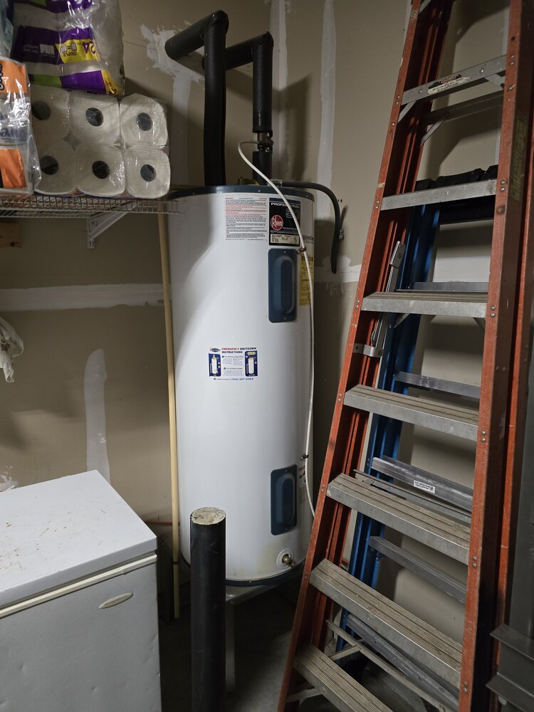

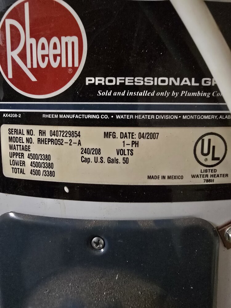

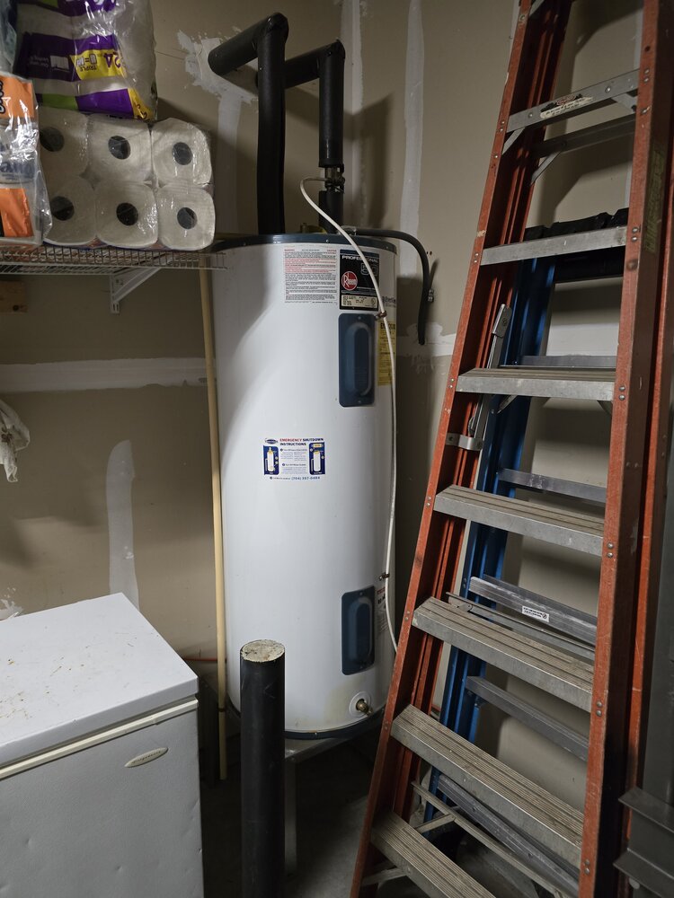

We currently have a Rheem 50g Mexico mfg. in '07, It's in the garage and on a little stand, I've got room for a larger unit and the removal and replacement seems easy enough that im questioning my current line of work after looking over some installation manuals and YTU. Parents budget is 2K but i'd like to get a solid no fuss unit for less if possible.
I'm interested in the Hybrid heat pump units but im not crazy about the complexity, I'd like something dumb reliable over bells and whistles.
Thoughts?
Thoughts?

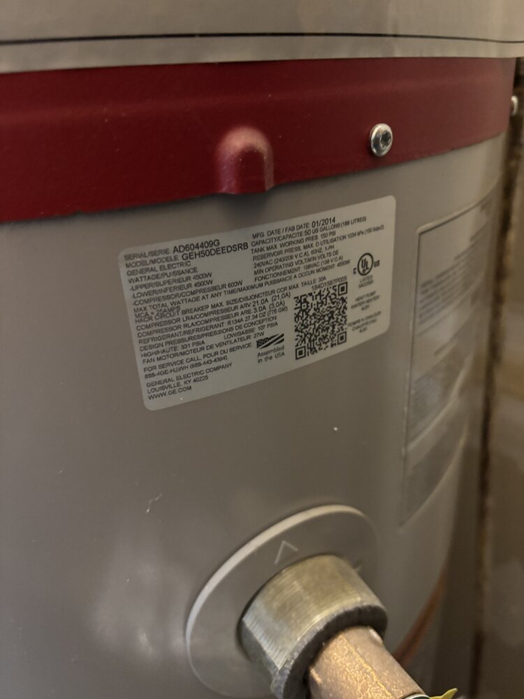

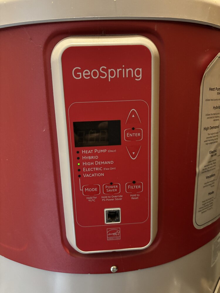

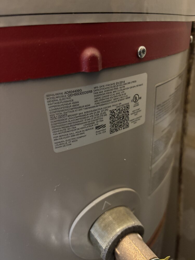

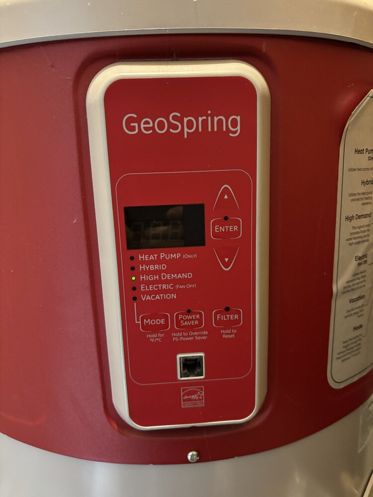

Ive had my whirlpool hybrid 50 gallon for 10 years and have been happy with it. Its very simple, all you have to do is clean the filter a couple times a year.
Just saw this looking through their site.

@Darkbloodmon What exactly is wrong with your parents unit? If its "going out" that means its still making heat because it hasn't "gone out", right? Its a tank, with 2 heater elements, and 2 thermostats/controllers. Pretty darn simple. If its not making heat, either one of the elements has burned up, or the controller is malfunctioning. You can buy replacement parts for all of that at LowesDepot for like $100 and change it yourself.
@Darkbloodmon I guess it wasn’t stated but what you posted above gives no description of “why” they think they need a new WH and why they called in the first place. Or, if Jenkins did any sort of diag either. WH are pretty simple in nature until you get into the much more fancy models with circuit boards and such. I’d be interested in diagnostics before just firing the $$ canon
Agree. Unless the tank itself is leaking, cheap parts can be swapped to make it work properly until the tank rusts through. I've replaced a handful in my life and I've gotten good life out of them all with easy to replace parts.
Thermal expansion valve has a constant flow thats increased over the past two years, and the tank has never been flushed in 18yrs. It was recommended to replace the unit due to age and lack of annual maintenance. Still makes heat, but the amount of hot water has fallen off in the past few years, they wait after showers/laundry for the system to refill.
Being that old with no maintenance it is probably just waiting to spring a leak but like commented above a few simple parts could potentially get it working well again. If there is a catch pan that routes to a drain I would just wait it out since the leak would not ruin anything. Figure out if an element or thermostat failed, replace the anode, replace the pressure relief, keep rolling.
Oh yeah, check system pressure and PRV! Ask the guy that had a new water heater only live a year due to 100psi. :shaking: :homer:
Had great showers tho.
(Edited for correctness) Most expansion tanks come preset to 40psi, if you have 100psi from the city that expansion tank might as well not even be there
The thermal expansion valve has a line hooked up that routes runoff to the exterior of the house, they've been monitoring it for a while (years) and it's got a constant drip and the area is permanently soggy. At this point they just want a replacement, it's a small miracle a unit this cheap didn't fail catastrophically without any maintenance.
