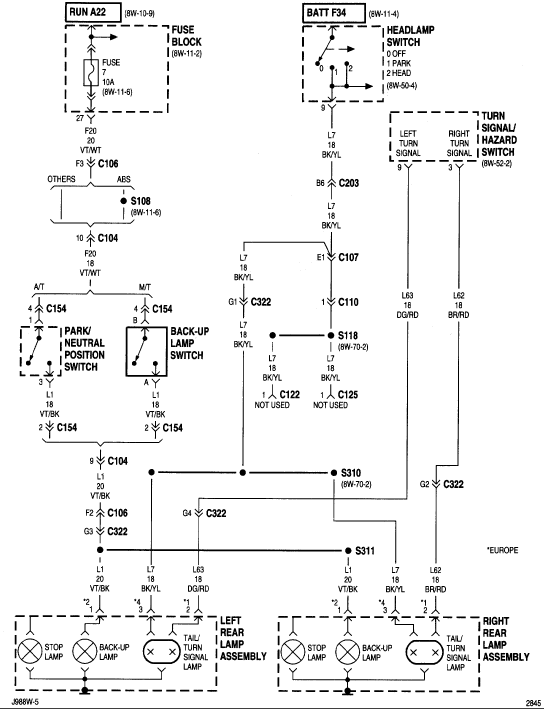

I need some help. My 98 TJ has a wiring problem. The rear tail lights do not work. Brake lights and reverse lights work but no tail lights. I am very electricaly challenged, so how do I go about trying to fix this?
So L7 is the power for your tail lights. Check for power there, each one of the two "V"s is a connector. Check for power at each one till you find power and close to there will be where your problem is. The wire on the bottom that goes to the stop lamp and back up is your ground, check it as well..
