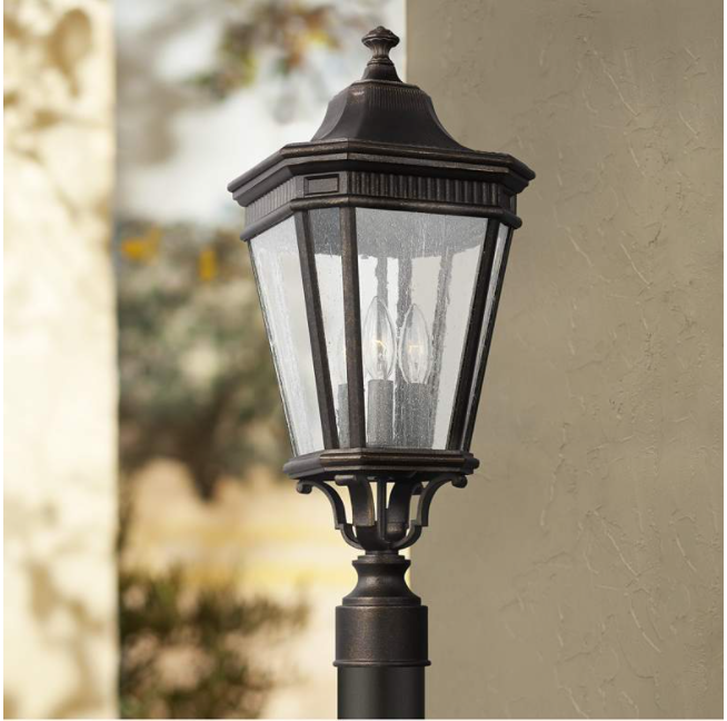

I know very little about house electrical stuff. I would like to power four lights like the one posted below using 12V landscape power supply. Am I thinking correctly that I can just run the 12v landscape wiring up to the lights and install 12v candelabra bulbs in place of the normal 120v ones?
The internal wiring is just delivering electricity from connection point to the socket. No reason the fixture would be voltage specific unless you were getting to connect to a higher than rated power source. But I didn’t even stay at a Holiday Inn last night.
That is what I am thinking. I've just never heard of anyone doing it.
Problem with 12v is voltage drop. Depends on distance and number of lights.

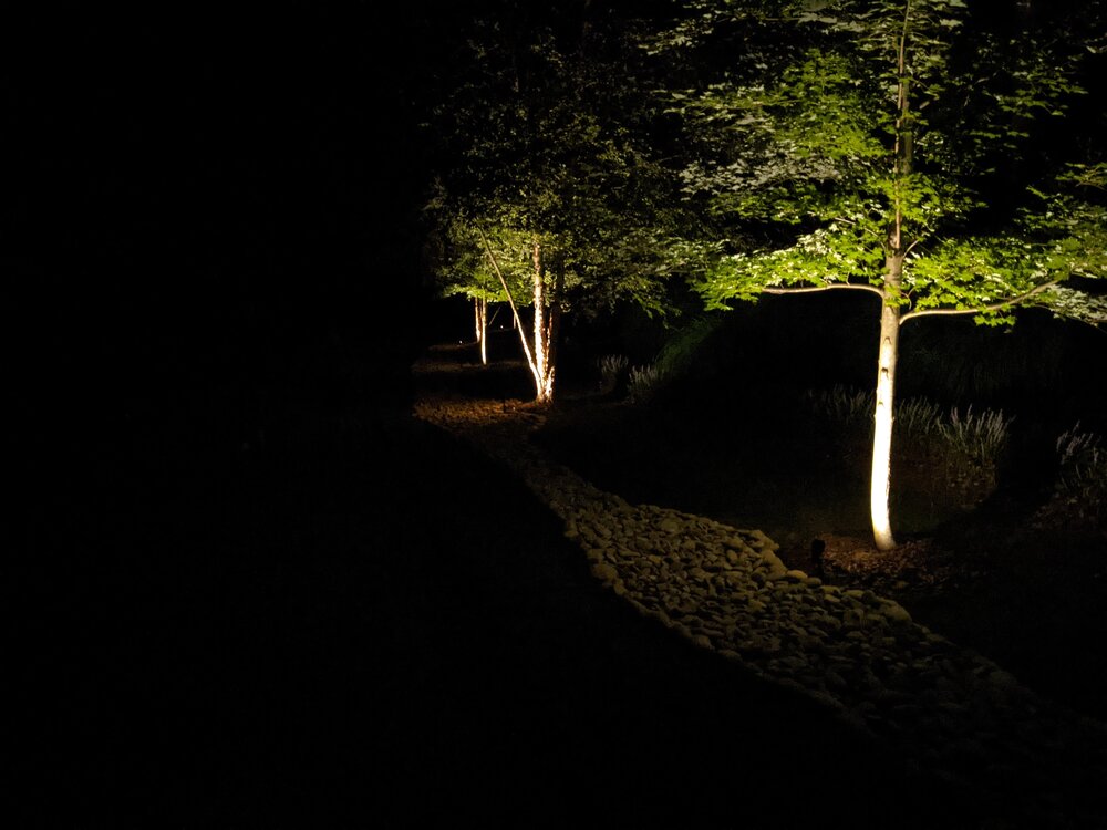

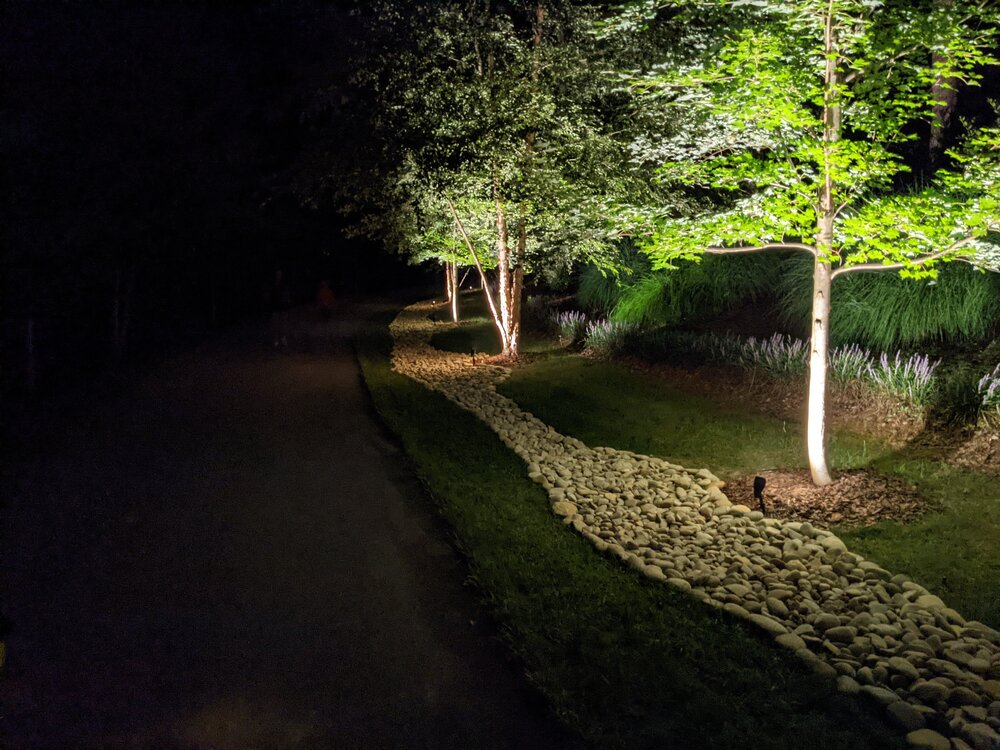

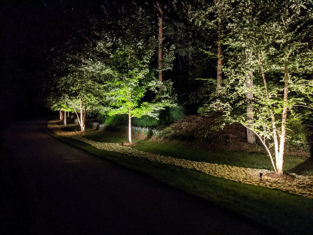

I was worried about then when I installed landscape lighting down my driveway, but it wasn't a problem. I've probably got 300-400 ft of wire ran out and about a dozen lights connected to it. They are all LED, and work fine.
Got any pictures? Want to do the same but was worried about that.
Here are a few pictures. I took a couple the bottom two with 'nightsight' to see if they would come out better. I just used my phone.

Just looked at the lights and voltage calculators. 9w lights at 12v draws 0.75A. At 300ft with 4 lights connected the voltage drop is around 3.5V or 30%. Seems like they should be much dimmer from the first to the last.
Unless they really only require 8 volts to oscillate and anything over that is just gravy.
I can't tell a difference between the furthest one and the closest one.
NOTE: Most LED landscape lighting fixtures can operate with full illumination from 9V down to as little as 6V. It is possible to have extended length runs with LED fixtures that go beyond the specifications shown in the guidelines above.
on the product page
