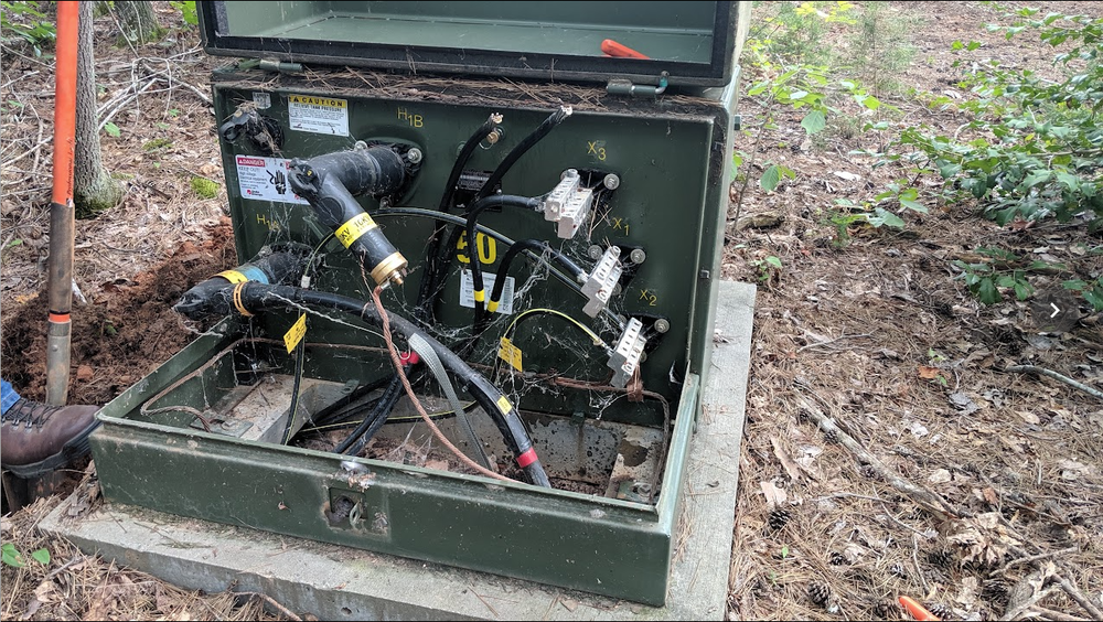

Ive had an electrician come out.
The house is about 20yr old. Nearest pole is 40 yards away. The line is underground from there to my meter. My panel is directly opposite side of wall from the meter. I have verified everything is tight and breakers reseated in the panel. Mains are tight.
Anytime i turn on any kind of demanding device (on any circuit), whether it be the AC, Heat pump, Keurig - new ones that are on demand no boiler, air compressor, etc. All lights in the house dim from the demand. In the case of the Keurig, for the length of the brew all lights flicker. Non stop. And again doesnt matter what circuit I have the keurig plugged into. Oh also doesnt matter if I have LED, Incandescent, or Fluorescent bulbs - they all react the same.
The only input the electrician had was that maybe something was loose at the pole?
Need to fix this before I finish the flip and AirBnB it.
