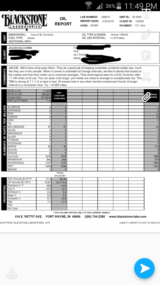

Finally did an oil anaylsis on the tow rig. Wound up running it for 12k and that happened to be right at a year, so it worked out pretty well. I was running Amsoil 15w40 OE diesel oil, which isn't really suggested for use with extended oil change intervals, but it performed very well. The filter was one of their EaO52 filters.
How much does an oil analysis cost?
28 bucks, add 10 if you want the TBN test.
