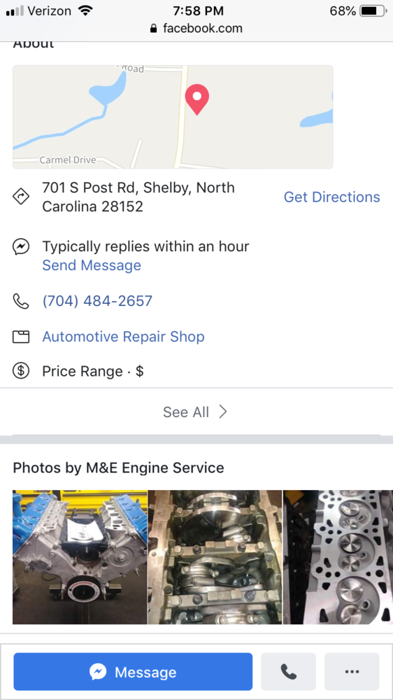

M & E Engine Service in Shelby. A close friend owns this place and they do great work. Might be booked for a while you’ll just have to check.
