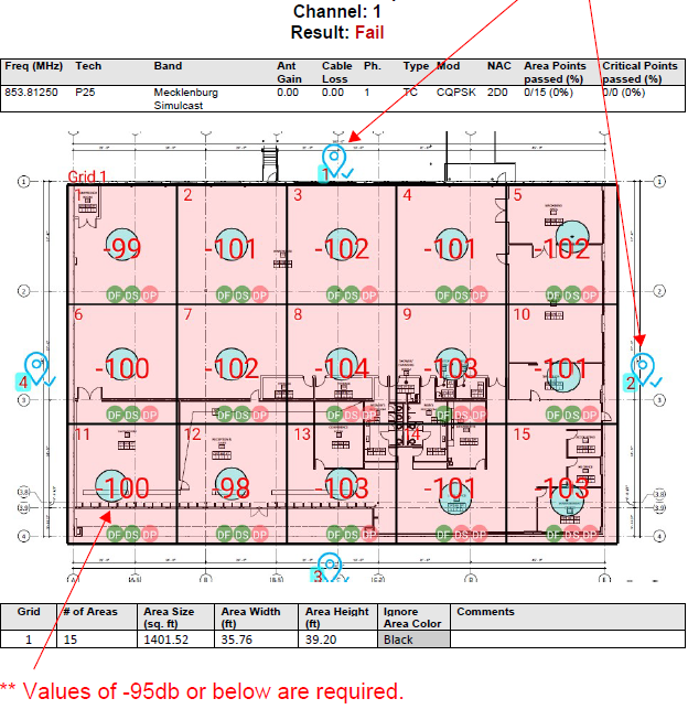

Company I work for is building a new 22k sqft tilt wall warehouse and code requires sufficient radio coverage for emergency responders. The contractor had one company come and do the testing, and they just so happen to also sell and install repeater systems, so much to (not) my surprise, the building failed the test. The solution of course is a $45k system.
I know alot of you guys know a lot more about this kinda stuff than I do, so I guess I am asking for advice. Should we get another test by a more independent party? Is there another/better/different option? Does the price sound ridiculous? Can we just sign a waiver that says it'll be aight?

Here's the test results if that is helpful:
How far along is the building? Could someone from the FD/EM/inspections come and test their radios? I know we have walked through buildings under construction before testing signal, but I don't know any of the technical stuff behind it. As a skeptical person in general I would get another test/quote, but as a FF anything that can make interior communication better is worth its weight in gold.

They're pretty much all going to fail. That's why the test is required - because 90% of the time there's no coverage. The price doesn't sound out of line. I would have guessed $25-50k.

I've never heard of this. And what system is required depends on what band is in use. Pretty much all of your urban and suburban areas at least using P25 VIPER PHASE 1 systems, but a lot ore using PHASE 2 trunked systems. I would think it would be up to the EM agency to ensure they have coverage. But 45k for a P25P2 system is cheap IMHO.
My Fire Marshal said he ran into the same thing not too long ago with a giant indoor personal storage building. Communication company came and tested and the whole building failed the test. We brought our radios in and tested throughout the building and we didn’t have any noticeable loss of performance. Our Fire Marshal approved it and signed off on the structure. He stated it was retroactively added to the code sometime around 2015. Our FM also states Horry County, the giant county just above us, does the same thing. They don’t go by the testing company, they just test it themselves using their own radios…If it works they pass it, if it doesn’t, then they make them add it. It can be done after the fact pretty easily in some of these large commercial occupancies. If your local inspector seems a bit sus about it, let me know and I can put him in touch with our guy so he can give him his interpretation of the code.

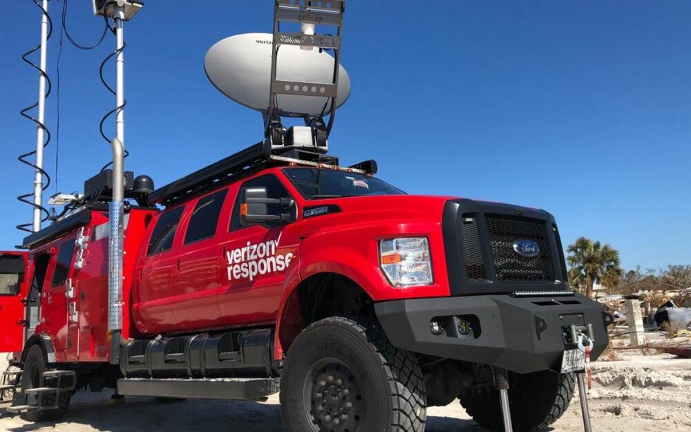

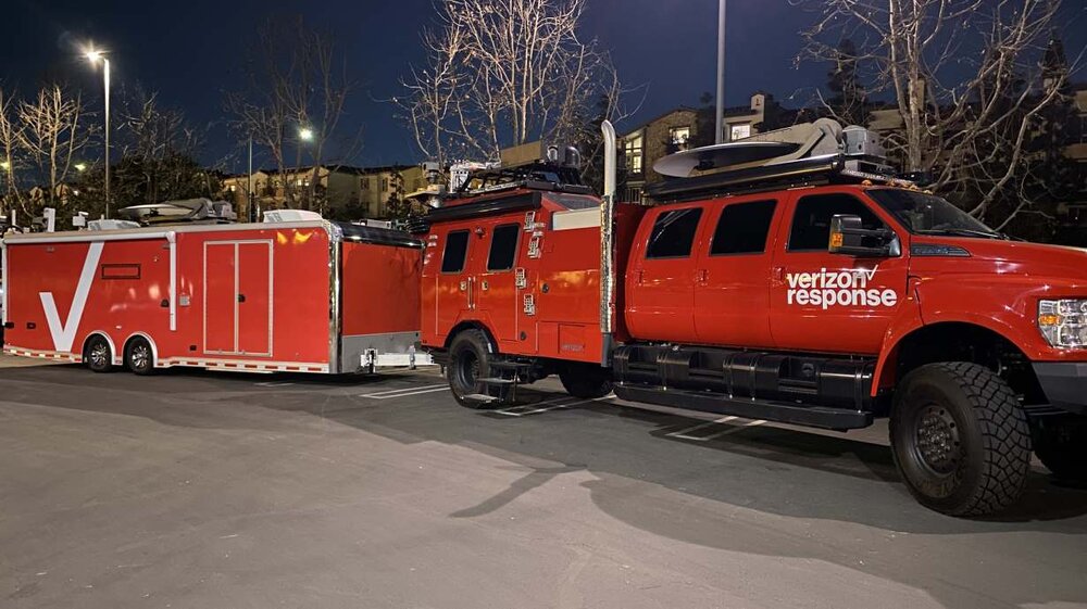

I use Verizon for our Dept. just because their network and 5G is the most robust, and if we have a major storm here on the coast where towers are knocked out, I can request THOR and THORS Hammer, or their mobile trailers for network access. But now with Starlink etc. We’ve got a number of options out there for communication. But even during our worst storms I haven’t lost comms with Verizon. While transparent to the end user, I can tell you Myrtle Beach Bike Week and Country Music Fest, priority access, routing and preemption works.

(THOR & THORS Hammer)

"...had a conversation with the Fire Marshal today. She advised that they do not perform the Radio Repeater Test, they do not possess the equipment. Per the attached Manual from Mecklenburg County’s Fire Marshal’s Office, the building owner is responsible for demonstrating that the “existing radio signal levels inside the building meet the minimum criteria”. She needs to see documentation that the signals are better than -95db inside the building or else she will not allow the building to be occupied."
....looks like they're going to go the hard route on it. I knew ultimately it was going to be up to the AHJ, and you never know which way they're going to go on it. Frustrating, I know.
