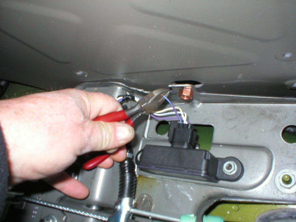

This is under your console. You could run either end of the wire through a simple toggle in order to have ESP function or not. Early JKs were plagued with an overly sensitive ESP system that would activate prematurely. Later ones aren't as prone.
9 times out of 10 it stems from a steering wheel that is off center with the wheels straight ahead. The steering angle sensor is primary input for the logic of the ABS/ESP/BAS system.
Hope they grabbed that quarter before they buttoned everything back up.
