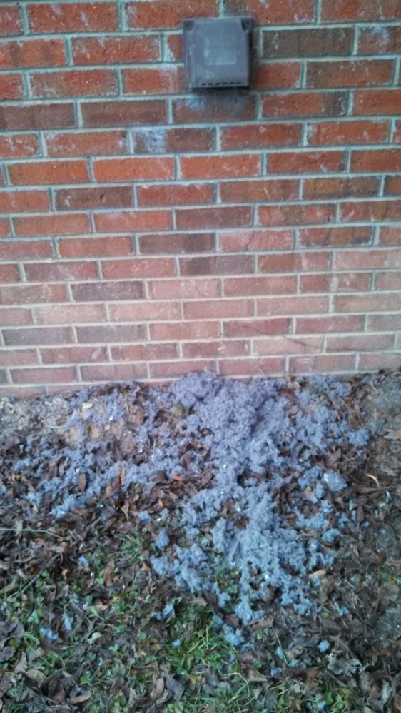

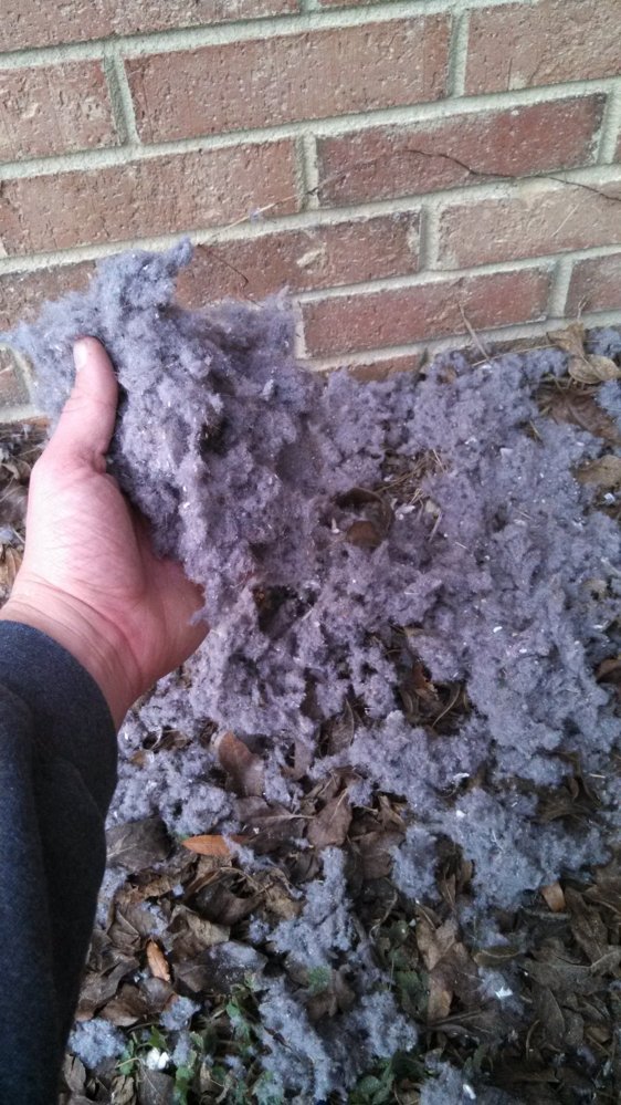

There is over 15000 dryer vent fires each year.
This is only half of what I got our of a 3 foot dryer vent pipe.
I hope this thread will make some people realize how bad it can get and that its dangerous.
