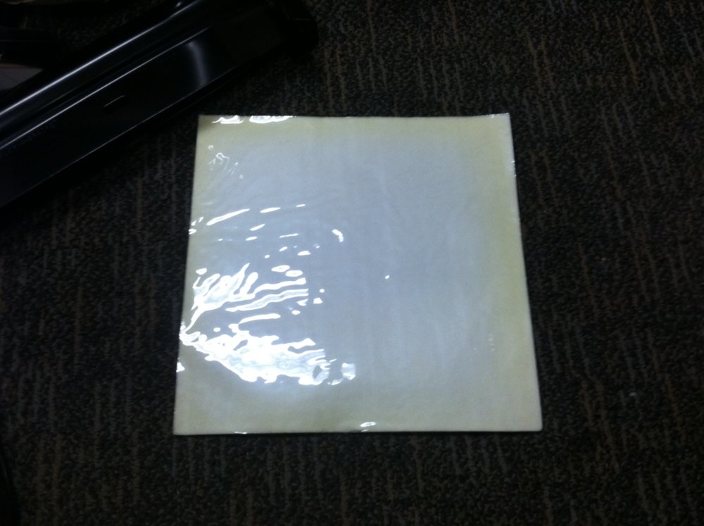

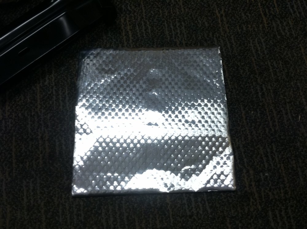

That stuff works too. Obviously the thicker the insulation the better. We use some adhesive backed insulation with reflective metal backing on the underside of the cab floor. I still have some sample pieces I have been hanging on to in case I need them for a personal project some day, LOL.
